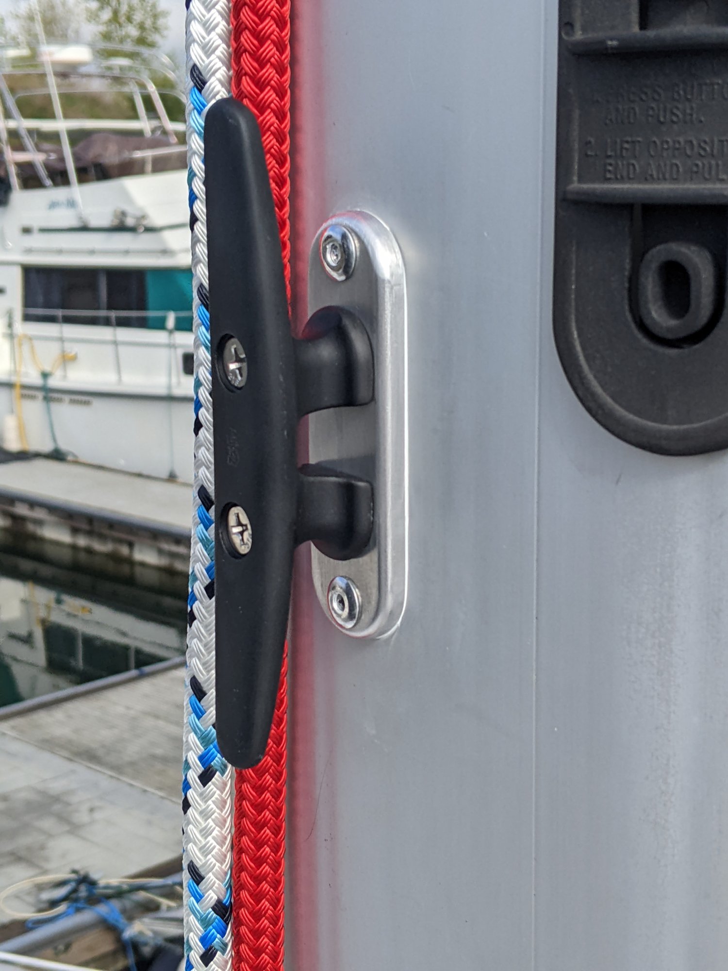

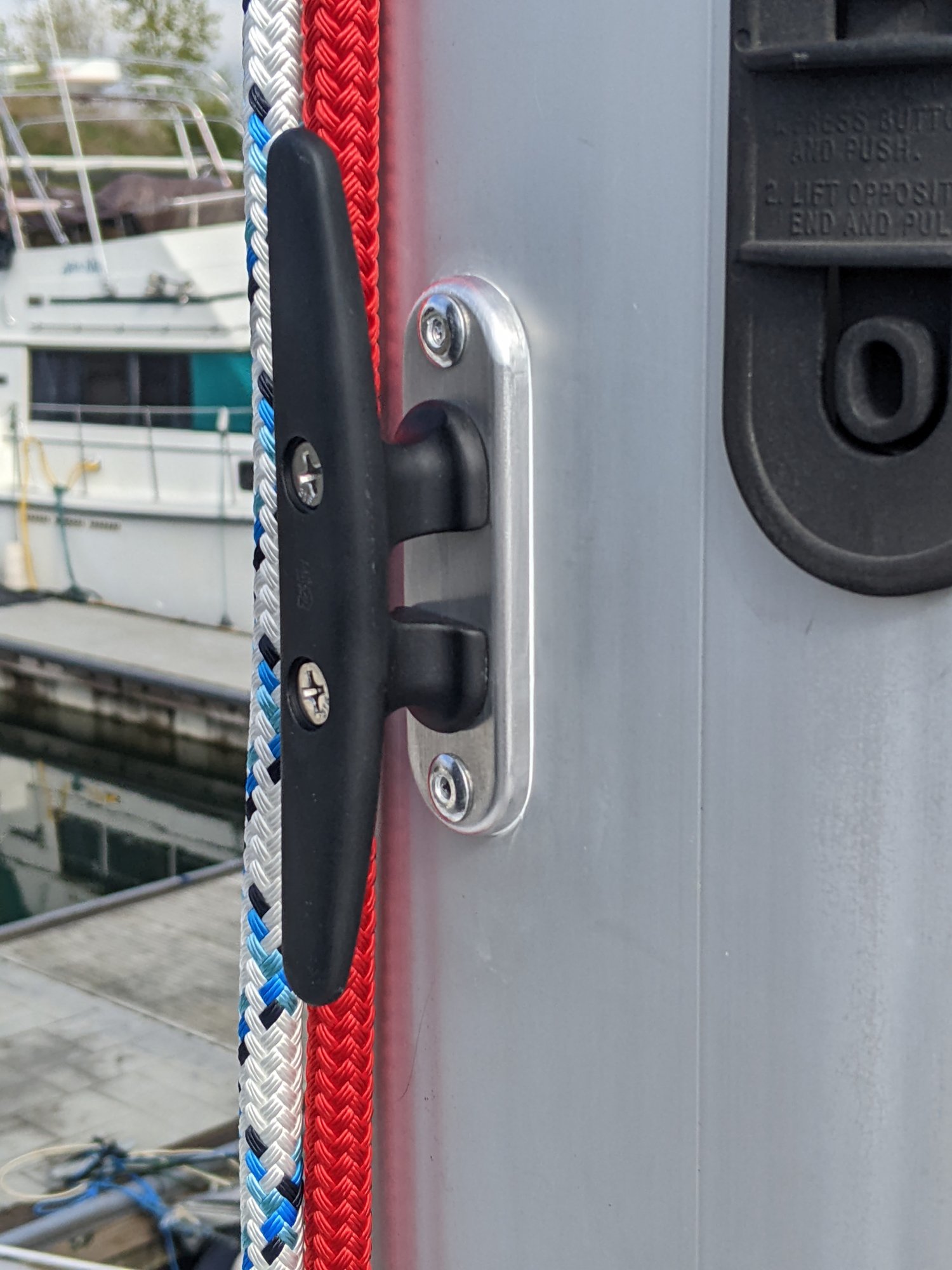

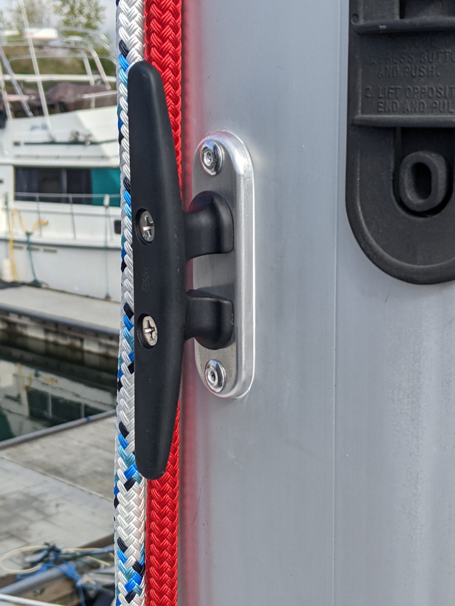

When we bought our boat the main halyard was run to the cockpit and the topping lift was tied off to a cleat on the mast. I wanted to be able to use the cabin-top winch to hoist someone up the mast and I don't forsee needing to manipulate the main halyard unless/until the mainsail is to be taken down. So, I added another cleat to the mast to allow cleating off the main halyard at the mast. I was replacing teh topping lift line anyway so I calculated the extra length needed to run the topping lift line to the cockpit. The cleat shown in the photo is actually on the port side of the mast and the red line is my jib halyard.

On our Selden mast with in-mast furling, the boom is specified to be at a slight up angle. Seven degrees comes to mind but don't use that without verifying.

Hello, thanks for the pictures. this is exactly what I have. Do you have the part for the white attachment?
