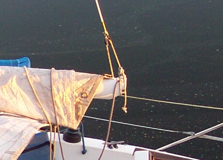

May 27, 2009
5
2 1984-37ft cutter Gulfport,Fl
Re: Found a picture.
Thanks Jonhnb. Your picture explains the piece of rope hanging off the cleat on the end of the boom. Run the rope thru the halyard eye and thru the eye bolt on the end of the boom and tie it off. Hanksga20
