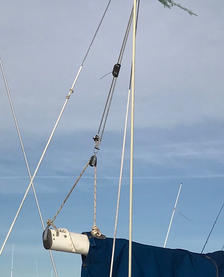

My C30 has a strange topping lift setup. (Photo below) What is there now is a block at the mast head, a continuous loop of line down through a block and cam cleat. There are two spacers that keep the loop apart but lets it slide through the spacer. Below the block with cam cleat is another block. A line runs from the normal boom end tang up through this block and back down to and tied to the boom.
Of course this is succeeding in supporting the boom but all the tackle is a waste.
On my O'day I ran a single line from the mast head to a block with becket and another block, then to a cleat on the boom. This gave me an easy way to adjust the boom height.
Is this strange topping lift on my C30 a similar attempt for boom height adjustment? Just a previous PO's attempt to support the boom with whatever he had?
I'm thinking of two solutions. Replicating what I did on my O'day or using the spare halyard blocks on the mast and run the topping lift from the boom up to the spare masthead sheave, down to the spare mast exit block and back to the cockpit where I can use a line clutch to hold the TL and raise it with the halyard winch if needed.
This is usually the case. My fix would rely on whatever I had on hand, too. I trust you'll follow suit. ;)

As Jesse said. There should be monofilament lines running from the rectangular blocks through grommets in the sail to pockets at the foot of the sail. When the halyard is released, the sail flakes as it descends.

it's certainly not a dutchman which eventually came standard from the atalina factory like my 1991. among other things, the dutchman had two vertical ine from the bom. both of which ran through the mainsail
2,978
Catalina 320 Dana Point
It certainly is the remains of a Dutchman flaking system, if you don't use it you can replace as you wish.

So it’s not part of a topping lift so it will be replaced.
Does it make sense to use the currently unused 4th halyard position for the topping lift?

The bottom section you see is the adjustable portion of the Dutchman topping lift, on the mast end is a block between the doubled adjustable section and the single line topping lift holding it up. You may be able to just remove that doubled section and find the single line part is already long enough and is/was actually the topping lift before the addition of the doubled section.
YES! I don't understand why more boats don't do this. Use the 4th halyard spot and use the same diameter as your main halyard (you need to check the size of the sieve to make sure it fits). Then you always have a backup halyard if something goes wrong with your main halyard.
It actually is a topping lift, and can be used as one, and setting up the 4th halyard as Jesse described makes sense too.
