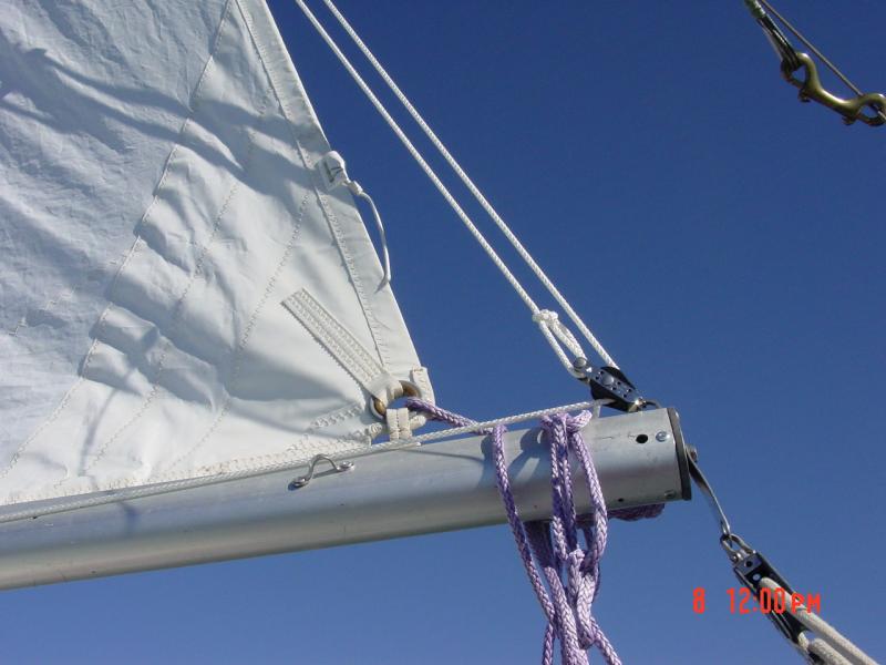

That probably depends on the year. On my '88, the topping lift is dead ended to a pin at the masthead and through a block at the end of the boom. It is controlled by a jamb cleat near the gooseneck. So the required length is leach plus foot.
Feb 20, 2011
8,060
Mine is terminated about 2 feet above horizontal with a small block. There, another line takes over, with a two to one advantage leading to the cabintop.
