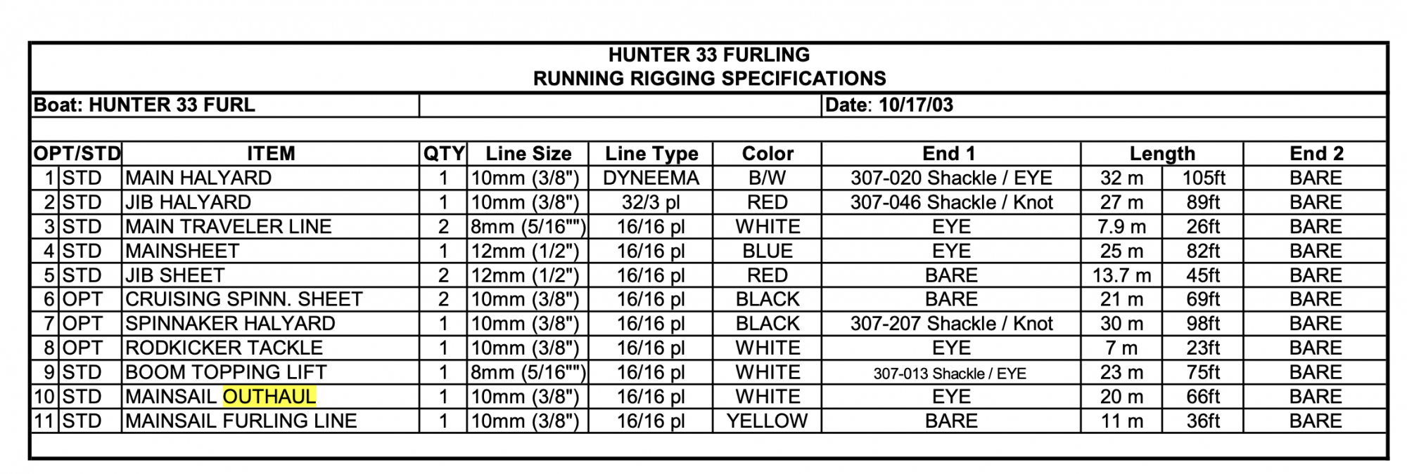

I got a 75' boom topping lift line cut from Chicago Marine to replace the existing line that was in bad shape. It's the correct distance, and this distance came from the manual page (attached). The issue is the line is too short to come through the mast hole where the existing line is run. This leads me to believe that the existing line is run incorrectly, but I can't find any diagrams of how to attach the boom topping lift to the mast and where to run it. P is 12.5m, and E is 4.45m for the furling setup. So the hypotenuse is about 43'. The existing line seems to be run through a spare halyard labeled port in the Seldon mast, which I assume is toward the top. The boom line spec is certainly less than 83', so I'm just confused. Any other 33-2 owners with some pics?

A clever carpenter once told me; (as I was opening a manual to get the length of a piece of wood...) Measure twice cut once.
It is possible that a previous owner modified your mast tie point for the topping lift. It is possible you have a taller mast than the line measurement was intended.
As a rule I always measure physically my own lengths then add 10% (or sometimes more) when buying line. If I have extra I can always find a use for the extra on the boat. If I buy short then there will be a line on the boat that needs to be repurposed. I have learned to use the manual's specifications but before I go forward I must verify there was not a typo.
Fortunately line has many uses on a boat. How is the condition of your main traveler line? maybe the fenders can use new line tails to secure them to the the life lines.

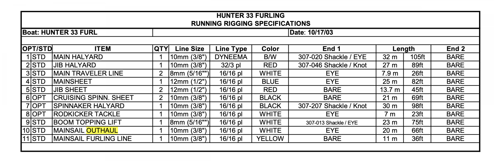

Always possible the manual has the wrong figure. I based the purchase of new running rigging on my Catalina 315 on the figures in their manual. They were pure fiction....numerous lines too short.
