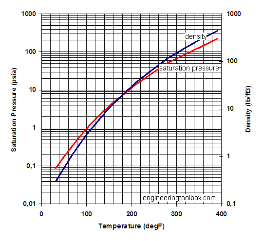

Not to belabor the issue but the ABSOLUTE humidity at 32°F and 100°F isnt 'all that different' and the 'Saturation' of the oil by atmospheric water will still occur, albiet at a slower rate but none-the-less will eventually go to full saturation (depending on the temperature).
Only when the temperature reaches approx. -40° is air considered 'dry' and in industry we 'pad' or blanket oils with -100 dewpoint (considered 'bone dry') air to affect dehydration of the oil; anything ABOVE -40° will saturate the oil with atmospheric water ... and temperature only affects the RATE of saturation.
The important thing here is if the oil is in contact (through a vent, etc.) with atmospheric air it WILL become saturated with water.
http://www.engineeringtoolbox.com/water-vapor-saturation-pressure-air-d_689.html

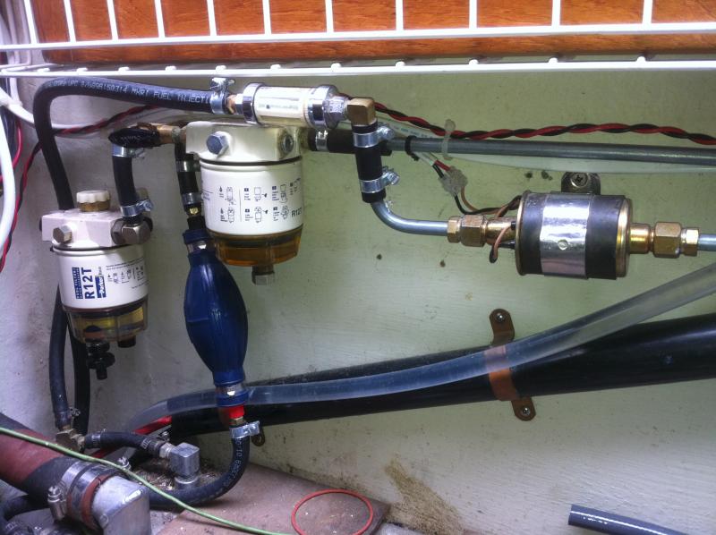

I am align with Mainesail. I rather ran it as empty as possible (less than 1/4), add diesel treatment before winter. Next spring I'll have fresh fuel.
Also, I have a strainer filled with blue air dryer beads in the vent line. and an on-board electrical fuel filter. See picture.
