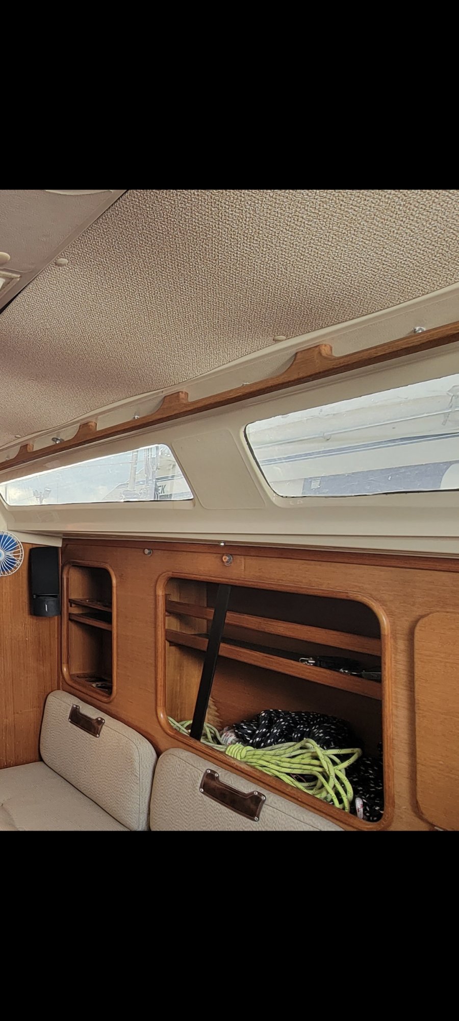

Mine (Yami33) are bolted with washers and nuts on the inside. The nuts are located just behind the cabin handrails. I can send pictures if needed.

Riptide....that is what I think I will end up doing. Drill all the way through and finish off with cap nuts and washers. The liner seems to be flush against the inside the core. Except in the closet and head, the liner seems to have space between the liner and cabin top core because it sounds hollow when tapped on.
Have you ever removed your outside hand rails? And how far forward do the handrail bolts/nuts protrude through the cabin top...into the closet and head?
23,593
You can see the acron nuts a washer behind the hand rail
I wonder if that was the original design or an expedient way to install handrails on the outside. The spacing does not appear to follow the boat builder's attention to detail.
