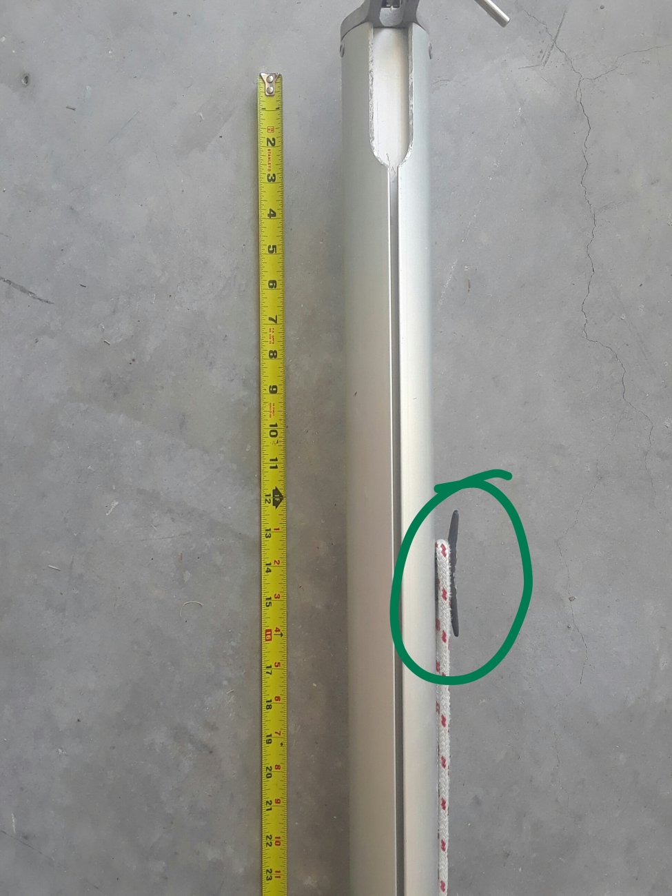

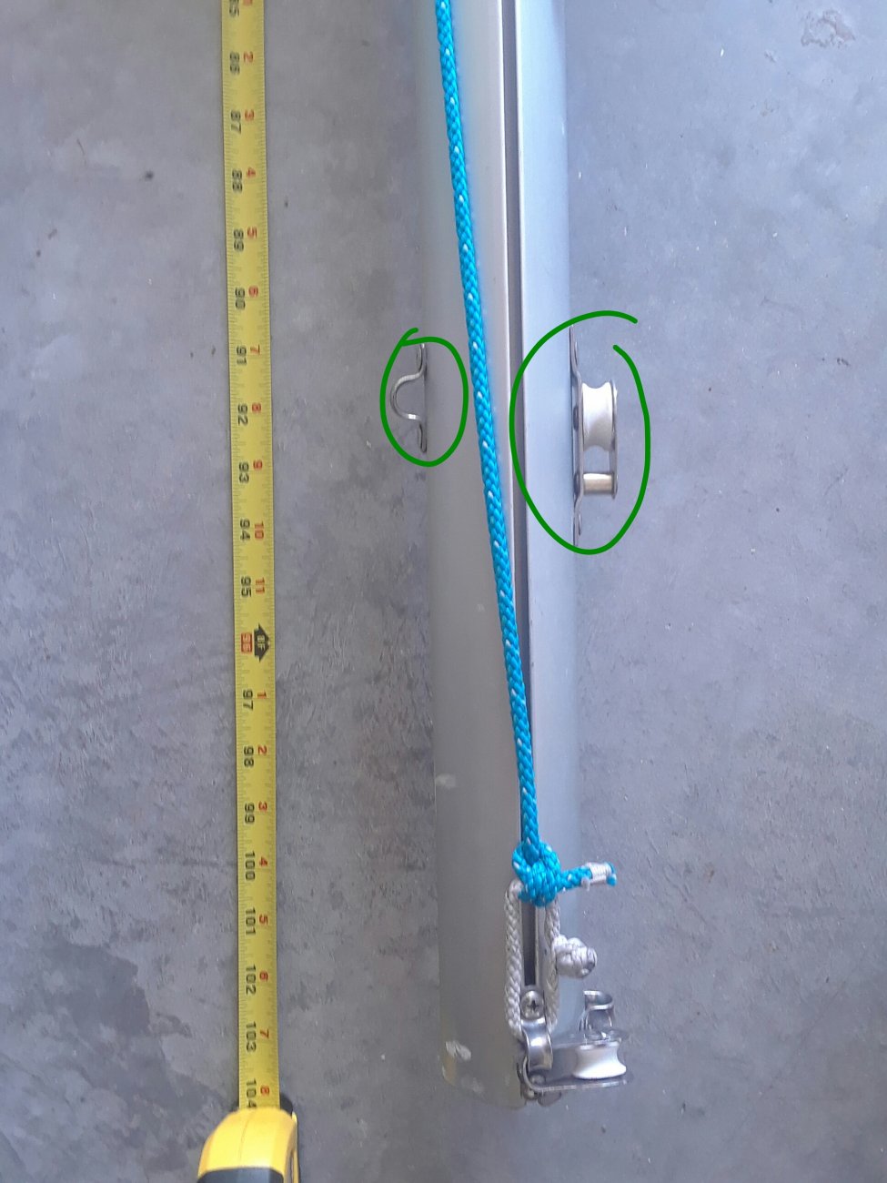

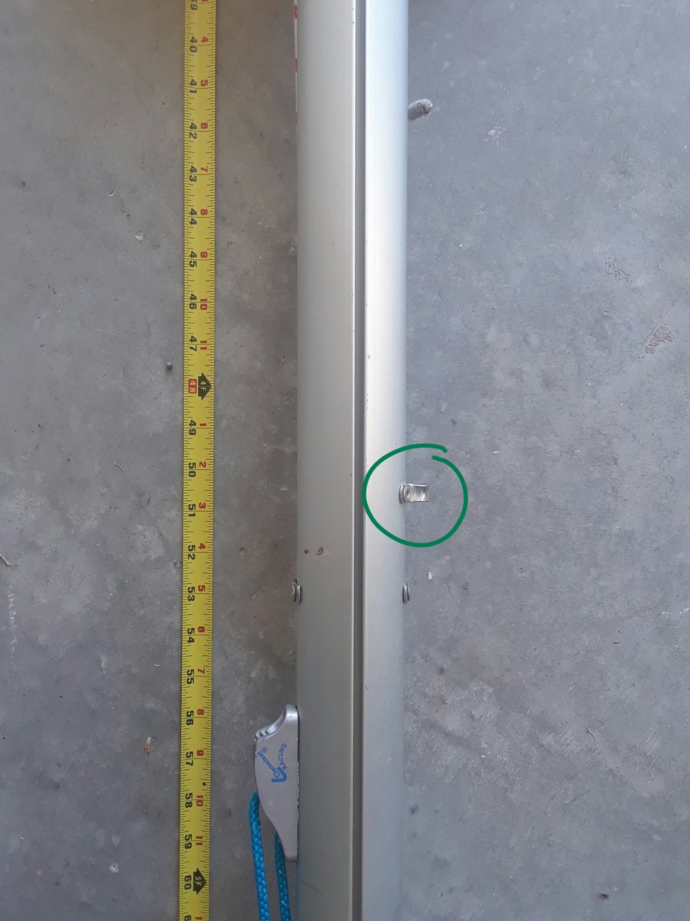

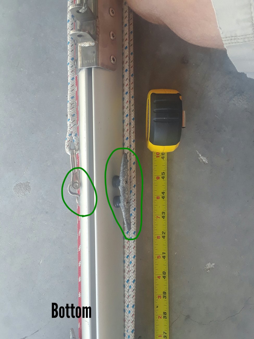

I am not sure how critical distances are. I think I can estimate off of a good set of pictures of both side of your mast and boom.
See if these help. I would double check your reef point to be sure the gromet is forward the boom eye and block.

Thanks you so much for those pictures.
So I sorted through my pictures and my boom and mast are missing 3 pieces yours has.
On the starboard side of the boom opposite the block on the port side yours has a padeye.
On the mast yours has the padeye and cleat below the boom mount point. They are also mounted rearward on the taper.
In looking at various 170's for sale I have noticed the booms have different hardware attached and some at different places. I know I have seen more then one without the starboard side block.
I will be adding cleat and padeye on the mast as that looks like a simple helpful thing for reefing. Plus that is not very expensive to add.

So I did some practice today.
I set up the sail and tried reefing without the additional parts (2 padeyes and one cleat) BobbyFun has on his 170. What I found is the clew and tack are not very well 'placed'. At the tack I just tie to the eye in the sail and cleat it off at one of the lower cleats. This makes for a very loose tack with movement side to side and fore-aft. The clew is similar and it did not want to pull tight. I can see how the clew would need the extra loop around the boom. to keep it down for tension on the roach.
I can also see why you want the reef line run to the forward cleat on the boom. Then you can control both ends of the foot from one position.
So I have added the padeye on the boom and the mast. I need to find a cleat for the mast. They use the dwyer aluminum cleat and I have not found another reseller with that cleat. Dwyer wanted like $16 shipping for the $15 in parts which would fit in a $2 package. I got some padeyes from WestMarine and pop riveted them in place.
