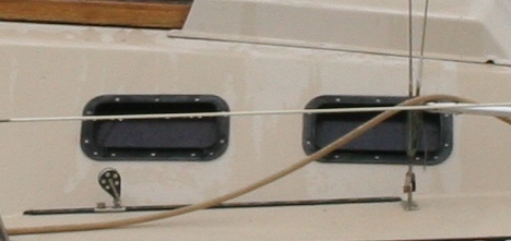

Took off my ports today
Feb 17, 2006
5,274
What a task. I still believe the previous owner used 5200 to attach the ports. Took well over two hours to remove 5 ports. I took one off several month ago for a test to see how hard it would be. It was a lot of work removing, cleaning, and then putting it back on. I have not sealed it yet, but it does not leak either.
Next is to clean the ports and do a leak test of the gaskets. These are opening ports and I know that there is some leakage from the seal. Will clean them up and check. Hope they are still good. Might have problems finding gaskets for my ports.
We have a 30% chance of rain tonight. So, why did I do this today? LOL
Using 3M painters tape to cover the holes. And yes, I do have some dry rot. Plan on digging that out and filling the void with epoxy. Don't think I need to cut out that portion and replace.

Guess I was in a hurry. LOL They are now home and I have the tedious task of removing all the old caulking. Boy my work is cut out for me. I do plan on using (Maine Sail's recommended) Butyl tape when I put them back on.

That's interesting information, thanks. My portholes screw from both sides. On the outside, there are twelve screws. I hope that will be enough to hold a good seal. I have a tube of 795 but by the sounds of it, that might not be enough for no more than one, maybe two portholes. We will see.

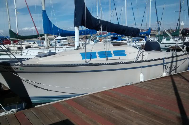

Any type of flexible Urethane glue should work. What ever you use, it needs to stay flexible, because fiberglass expands at a different rate than metal or Acrylic.
My windows are glued straight to the fiberglass. The PO apparently glued and screwed them with a hard glue. Every single window was cracked. 3 of the windows actually had gaping cracks in right down the middle due the different expansion rates. That was my first project when I got the boat. Pretty much took one evening per window.

I got a couple of the rings sorta cleaned up. Lots of caulking on all of them, but only on the bottom, not the top of the rings. I suspect this will take maybe three days. I won't have time to play tomorrow but Saturday I should have all the portholes cleaned and ready. Next step after this will be to clean the fiberglass of everything. Then I will set and seal all the ports in one day. Maybe Sunday or Monday.
