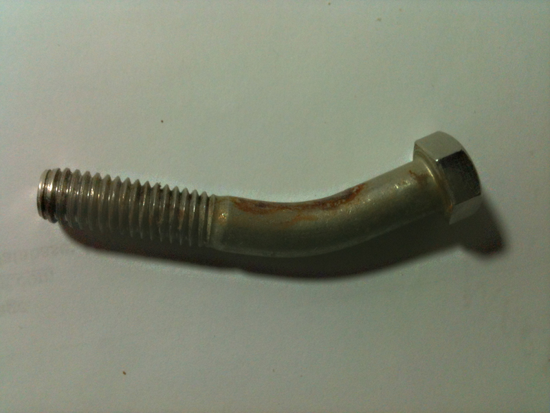

Lock it down and you will rest easier. The book says you should only sail without the lock bolt in very light conditions where it is unlikely to lay over. Once the boat heels past a certain point the keel may slam into the trunk, after which you probably have a lot of damage, but for sure you have a boat upside down that won't right itself.
I asked the previous owner of my Mac if he locked the keel down. He said "You can lock the keel down?". I pointed out where the lock down bolt was, and he said "Huh. Imagine that. I was wondering what that banging was." When I got the boat home and got the lock down bolt out this is what it looked like after letting the keel bang against it for 10 years...
