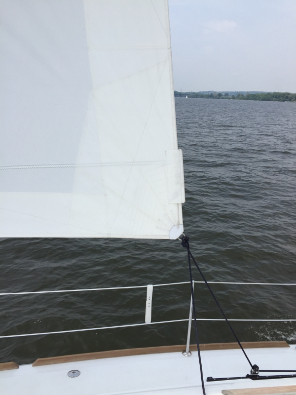

I've been having a hard time getting the luff of the headsail on our Oceanis 37 to break evenly. Close hauled in 8 kt winds I can get it balanced but I have to keep the fairleads one or two holes forward of what's recommended in the Neil Pryde trim guide for the boat. The bigger problem is that as I bear off to reach, it becomes pretty much impossible to keep the top third of the sail from luffing, even if the bottom is stalling. This is true even if I move the fairlead well forward of bisecting the clew angle. Attached is a picture of the sail on a reach (wind 60 degrees apparent, 90 degrees true, 7-8 kts true). When the picture was taken the upper telltales were reading luff and the bottom were reading stall. Also attached is a picture of the sheeting angle at the time. Am I missing something about how i should be trimming around this? This is the second season with the boat and the sail has been like this since new.

But also recognize that on a beam reach the same "telltale information" will NOT work, the head of your jib WILL luff and the bottom WILL stall, even if you can move the fairlead position. Next time out, try it manually and you'll see.
The reason is that a jib that works for going upwind is relatively flat. Only a completely fully bodied deep cut jib would even begin to provide equal telltales on a beam reach. That jib would be useless going upwind.

I don't think you can expect the tell tales to break evenly on a reach unless the jib clew is poled out. And even then I wouldn't expect it. Close hauled - yes. And then even a completely even break is fleeting.
On a reach the jib is over trimmed on the foot by virtue of the fact that the clew needs to be set outside of the rail - sometimes by a lot. Almost by definition you can't have the top and bottom both correctly trimmed.
You can become over focused by tell tales. It would be worth your time to read Buddy Melges book, I think, Sailing Smart. He is a proponent of using angle of heel to steer rather than strict adherence to tell tales.
You need outhaulers, or reaching sheets.
A tall non-overlapping jib like yours needs a lot of attention re shape. When slightly off the wind, the clew has to be moved outboard to give the luff the correct profile.
Here's a reach with the sheet in its track and held inboard. Nasty.
Moving the clew outboard gives a MUCH better shape. You can do this by running a separate sheet from the chainplates, or pull them out via outhaulers attached to the chainplates.

Thanks for the input everyone. Just to be clear, in the pic I had attached I had already moved the car well forward from the close hauled position. Don - I agree it's a pain moving the pin-set cars, but I'm making that compromise for now because we dock bow in so I want to minimize the lines in the area we often walk across the deck. Our old boat was a masthead rig with 150% headsail, and that one I could balance on any point of sail by adjusting the car position. With this fractional, non overlapping jib I haven't been able to match that, although Stu and shemandr have me thinking this is the norm more than the exception. I like Jackdaw's suggestion of an outhauler, but I'm not sure how I would rig that. Because the headsail is only a 105%, the chainplates are well aft of where I would expect to need to sheet to, although maybe because they're more out outboard I might be able to get away with that? I guess I have something to experiment with.

Update - I was able to go out this evening during our weekly club race and experiment a bit with a more outboard sheet. I ran a spare sheet through the mid-ship mooring cleat and back. The leech shape definitely looked much better; not as cupped inward as running to the regular fairlead when the apparent wind was behind 40 degrees or so. Unfortunately the wind was only about 2-4 kts and flakey, so I wasn't able to get a good idea of the luff balance, but the couple times that there was enough breeze to stream the telltales it seemed like it was no worse balanced than with the fairleads forward, even though the cleat is further aft. The chainplates are at the rail just in front of the cleat so I suspect they may be the best place to sheet to on a reach without having a pole. I'm going to try to rig a block to them for the next time out and see how that goes. Thanks again to all for the advice!

I did end up getting blocks and attaching them to the chainplates. Big improvement by doing that. We just run the sheets and attach with a bowline at the start of reaches. A shackle scares me a little in case foredeck crew gets hit with it, but if you're careful it's certainly easier than tying a knot.
