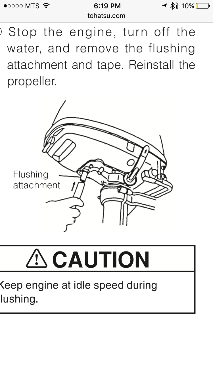

I have a new outboard for my sailboat, and I am struggling to find the port where the flush adapter should thread into. Location is not in the manual. Its not in an obvious/visible spot (I believe). Does any one have a picture of it?

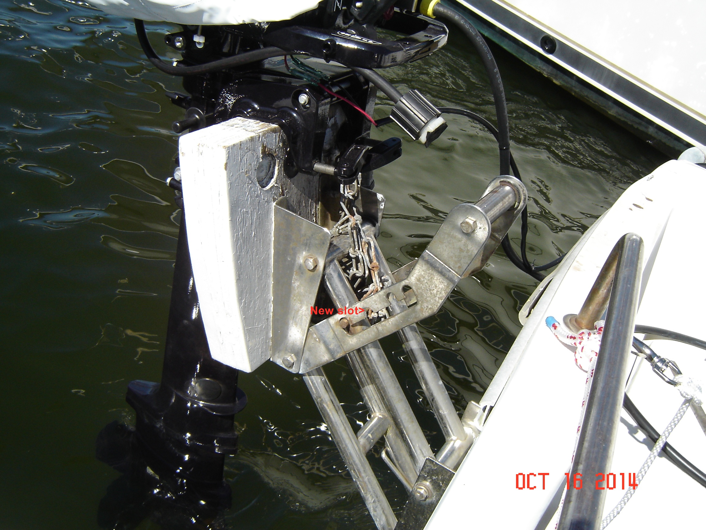

Get this tubing and hose connector that my oB dealer installed. Stays connected to flush port, just unscrew the white plug, hook up hose flush and put plug back in. You can see it in my pix leading around the motor to the front.

Get this tubing and hose connector that my oB dealer installed. Stays connected to flush port, just unscrew the white plug, hook up hose flush and put plug back in. You can see it in my pix leading around the motor to the front. View attachment 130572
That's pretty cool, I didn't know that was a possibility! Much better than a bucket!

Not sure which model you have but one of he manuals shows the adapter fitting on the underside of the power head aft of the shaft.
Jun 1, 2015
47
Macgregor 25 Venture Long Beach Harbor
I think that is what I needed to see. I had looked at those bolt heads, and unsure which one could be it. Pretty small.

If it's like mine it's painted white. I double checked today and that is the correct bolt/plug.
