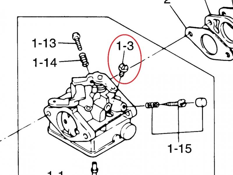

Found out today that on the Tohatsu 4/5/6 B and maybe C models with carbs that meet the stringent EPA standards and therefore have problems with E10 and other contaminants in the fuel, especially at idle due to an undersized low speed circuit, it is possible to replace the carb with the earlier ‘A’ model version which is less susceptible to this condition. Not advocating intentional by-passing of EPA regs, heaven forbid, but this may be a solution for those tied to E10 (which I am not). Out the box the B/C models run fine, and with proper attention to fuel care and the use of pure gasoline there should be no problems, but it’s nice to know that (for now) this option exists.
