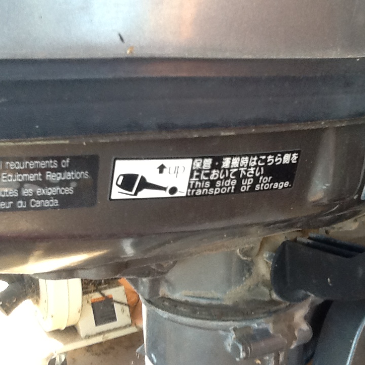

Hmm. On my Nissan 4 horse, same manufacturer, the proper stowed orientation is handle down...

This was actaully a Nissan 3.5. There are two lugs on the side of the motor opposite the handle that it rest on. The 2.5 and 3.5 both say to carry handle up. I think our 4 hp says handle down. I just follow the sticker on the side of them and the owners manual, that I just read.
