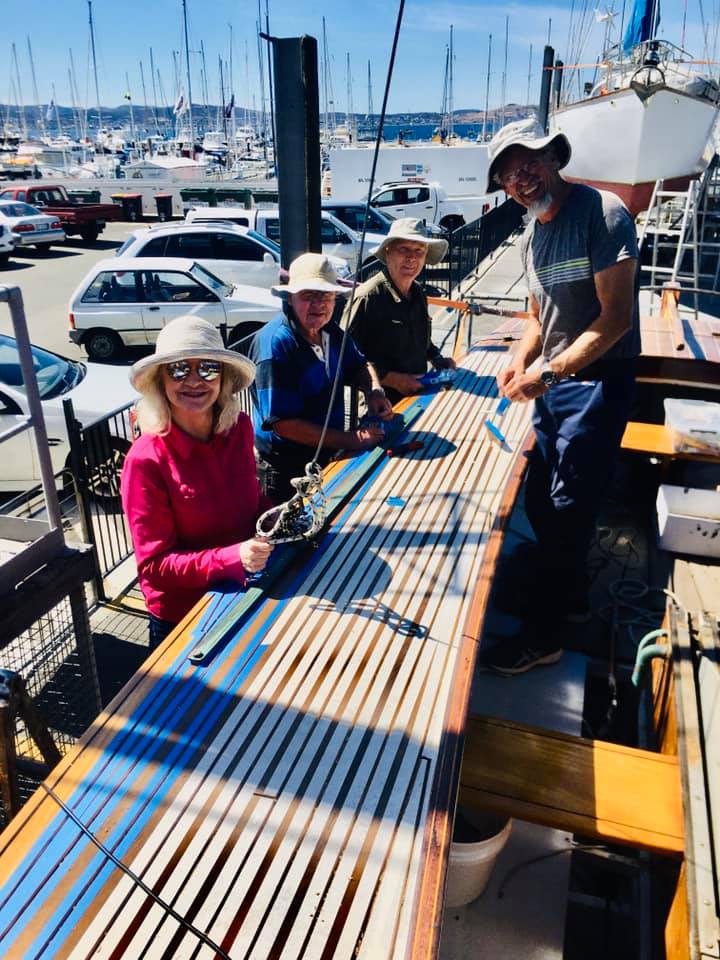

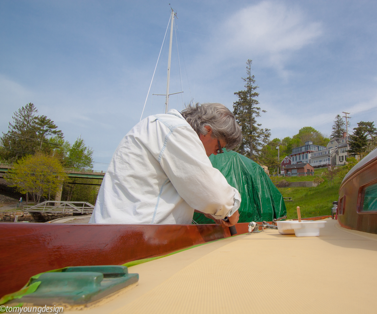

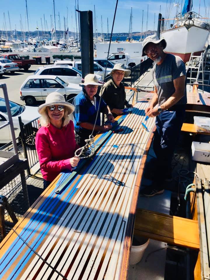

The only way to comfortably strip or finish toe rails is using staging. Nothing fancy, it can be saw horses and or step ladders to safely support a plank (within safe height limits). The goal is to get into a comfortable height that makes the work pleasant compared to struggling at odd heights on ladders or working from the deck.
To make short work of it, talk some friends into helping.

You're fortunate to have such good friends!
I wish! Not my boat, a shot of a nice boat staging set up. Working at a comfortable position is half the battle.
