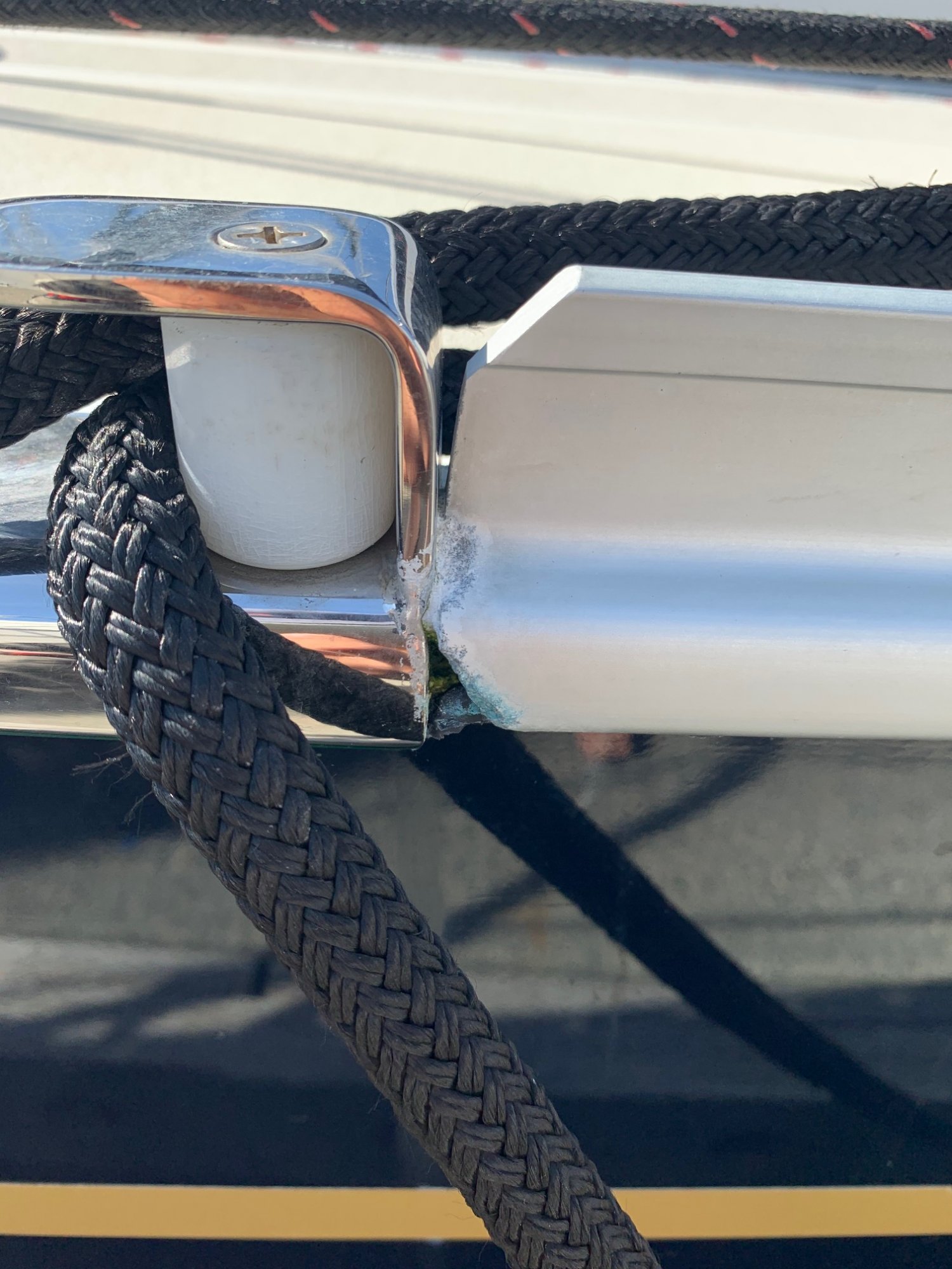

This is a 2nd, 3rd, 4th, and nth opinion question...what would you do to fix this?
forbin
Nov 4, 2013
166
Tartan 3700 Seattle - Elliot Bay
So take off the chock, grind down the aluminum to create a gap equal to the size of the bottom of the angle cut (top of the toe rail), then add a [plastic?] spacer to fill the gap? Or does all the corroded area need to be removed?
For background, this is on a boat I may be buying, so I want to know what to ask for or if it's not a big deal and I can have it done later, etc...
First sentence: yes
Second: just sand it down.
You do understand why that's happening, do you not?
Thanks. I do know why it's happening generally (or happened, but I assume it's still happening), but some things about it are confusing...
  • Why wouldn't there have been a spacer in there to begin with knowing what was likely to happen?
  • Why it would corrode with a particular pattern (the bottom part of the toe rail corroding at an angle rather than the pieces in contact with one another, if that's something that's predictable, or another part on the toe rail far away from the point of contact corroding if that's possible, etc)?
  • I thought that type of corrosion would occur fairly quickly, so is there a way to tell if it's a recent occurrence or if it's happened over years, or is the oxidized material providing a barrier between them and has stopped the corrosion?
  • This sounds like it isn't much of an issue once the metals are separated, correct?

I'm guessing it's something to do with production installation tolerances. I'd bet not every production unit fits up the same way. Some have gaps some don't
Brian
1. Look at the other side of the chock and then look at the other side of the boat.
2. Gravity.
3. True, but once the corrosion starts it could build up its own "barrier" between the metals and stop itself. You're right. If you want, read up on galvanic corrosion, it's an oft discussed topic that is not specific to boats.
4. Yup.

How wide would the gap have to be? Can't you run a hack saw or sawz-all in there then caulk it?
