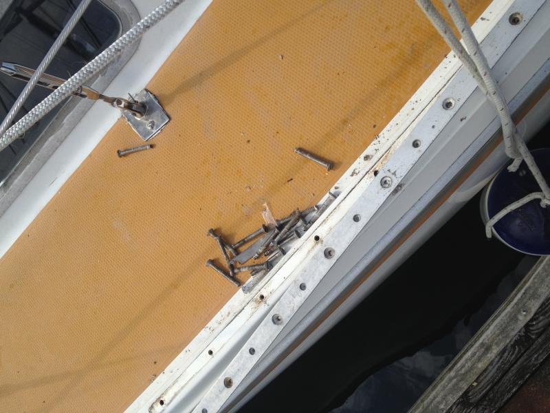

IMG_2604[1].jpg Not sure if I'm doing this right. I've tried to attach a picture of the port silde aluminum rail/track that we have removed and will be reseating. My question is about the corrosion on the underneath of the track. Is it a problem and how to deal with it.

I did this on my boat as well. It IS a source of water leaks with all of the holes that are drilled through it in the rail and the decks.
I recommend you reseal using Butyl tape around each of the holes through the deck, as well as under the head of each screw...you don't want to have to do this job again!
My screws were bent too...I think this happens when the nuts are installed on the bottom. There is not much room to turn the nuts, chich you HAVE to do when you seal the screws. DO NOT turn the screws into the nuts, or any sealant you use will fail, and you will have to do it all over again.
When you take the rail off, you will find it is not curved as much as when it was on the boat. The best way I found to reinstall it was to put one screw somewhere in the middle, then another on one end (doesn't matter which end). Then, it will take two people to bendthe rail back into place and put the screw in the end. After that is done, you will need to use a screwdriver or similar tool to "wiggle" the rail into place for each successive screw. Once that is done, start all of the nuts and tighten them down from the middle out.
It is a tough job given the lack of space in some of the areas, but much worth it. My boat was like a rain forest before, but is dry as a bone now!

View attachment 67535 Not sure if I'm doing this right. I've tried to attach a picture of the port silde aluminum rail/track that we have removed and will be reseating. My question is about the corrosion on the underneath of the track. Is it a problem and how to deal with it.
The corrosion is because water got under there. Just sand it off and clean it up.
I agree, butyl tape is what you NEED, not just want, Do NOT use silicone.
Here's the source and How To on butyl
http://forums.catalina.sailboatowners.com/showthread.php?t=117172
Good luck.

Corrosion
If you want stop the corrosion you'll have to do more than sand it off and reinstall.
Salt in contact with bare aluminum causes corrosion very quickly. Stainless steel screws in contact with aluminum cause corrosion even more quickly, due to the electrolytic reaction.
The first step is to passivate the bare aluminum. This can be done with any of several available conversion coating systems, such as Alodine (duPont). If you can't do that, at lease paint the bare aluminum surfaces with a paint htat will adhere to the aluminum.
To prevent electrolytic corrosion between the screws and track, they must be insulated. The best commercial compound for this that I know of is Tef-gel. It's expensive, but it works.
If you properly countersink the holes in the fiberglass gun'ls for a butyl tape seal, I don't think it's necessary to use butyl under the screw heads - use Tef-gel here.

I think we're talking 2 different things here. The picture is your fairlead track. Is the corrosion you're talking about under the aluminum T-Track or in the fiberglass deck. Looking at your picture the deck looks good and just needs a good cleaning. Hopefully your core isn't to wet. Follow Stu's advice and fill each hole with epoxy and re-drill them. Bed them with Butyl rubber. I did this on mine when I upgraded to a Garhauer adjustable fairlead system. I took the T-rails to a metal finisher and had them re-anodized. If I had time I would have hard coated (type III anodize). You can buy new hardware from McMaster Carr rather than reuse what you have. If I remember I think they are 1/4-20 but make sure before buying.
Garhauer sell new T rail too:
http://garhauermarine.com/catalog_process.cfm?cid=85
http://garhauermarine.com/catalog_process.cfm?cid=37

I removed and re-bedded my sail tracks this winter as well. Resolved the leaking I had, used 3M 4200. Interestingly, it seemed as if two different fellows installed our sail tracks. Starboard side guy installed it with bolts of unknown length and then went down the line cutting them all to length. Made it very difficult to replace the nuts once the track was down. All of the port side bolts were uncut and of varying lengths.
