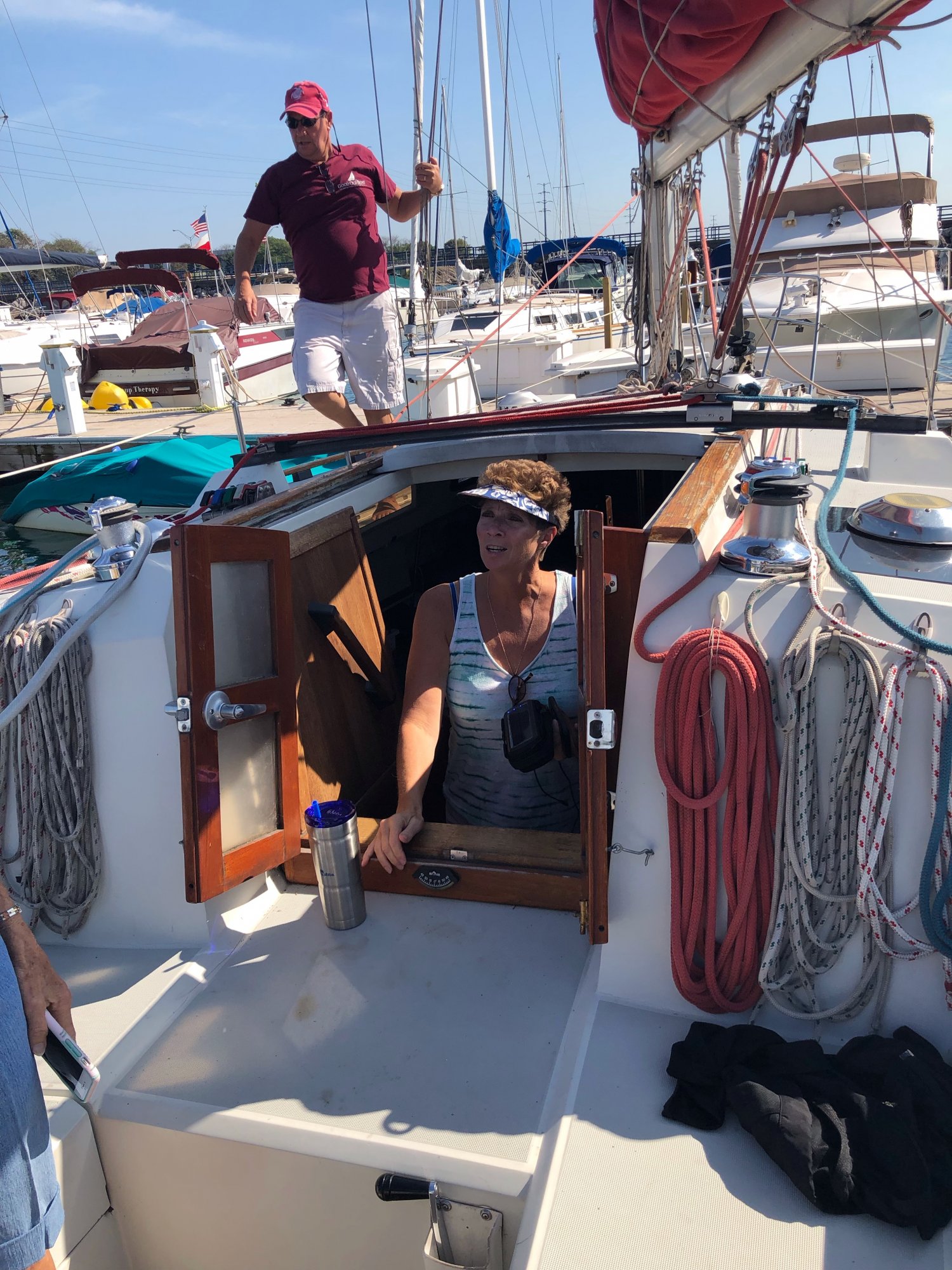

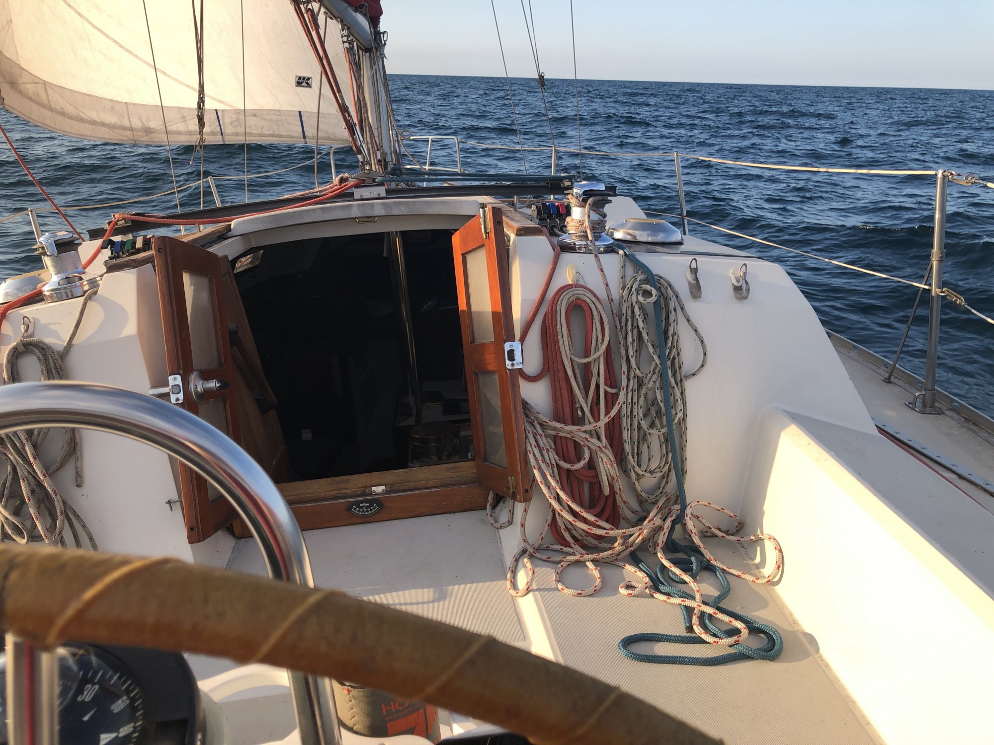

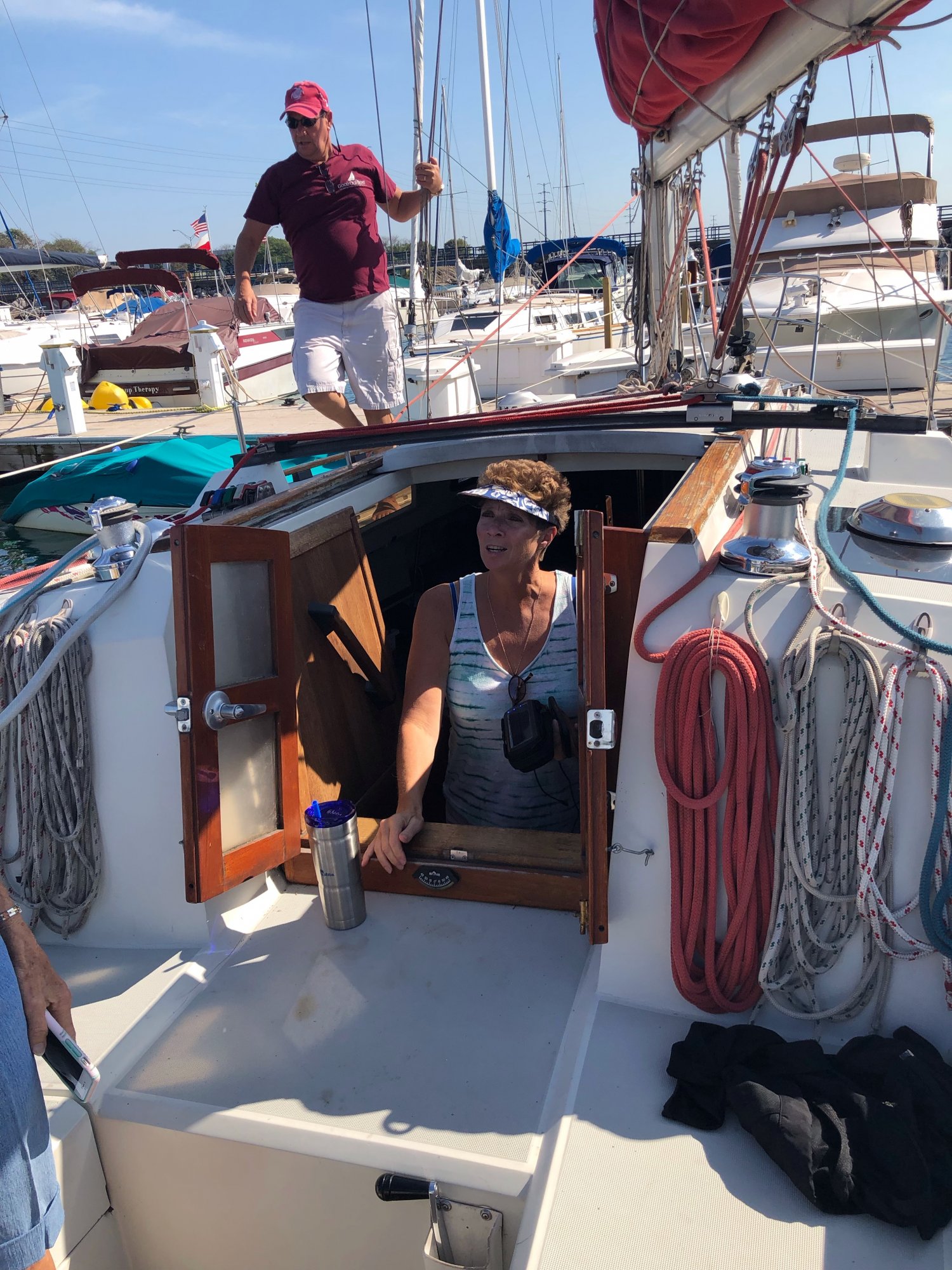

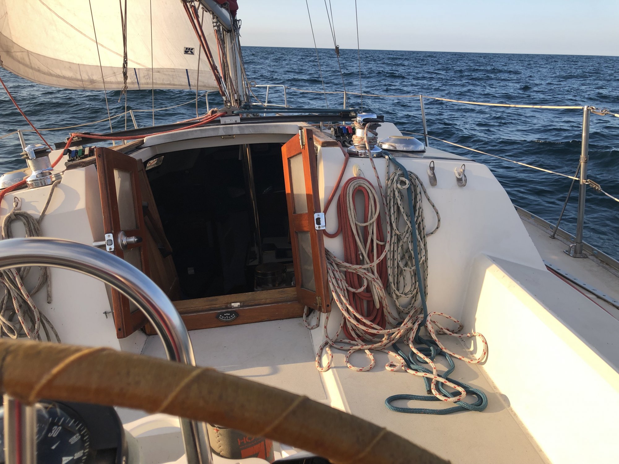

I have all the lines on my O’Day 322 led aft except my topping lift…will change that at some point too. So much safer and easier to work from the safety of the cockpit, especially if you are in rough seas.
You will a couple of rope clutches, the mast blocks, 2 deck organizers, and the winches.
On my boat, I have main sheet, main halyard, reef 1, reef 2, spin halyard, vang, outhaul, and jib furling line all run back to the cockpit, using 2 quad clutches and 4-line deck organizers.
The ONLY” downside I can see is a clutter of lines in the cockpit (mine are coiled on line holders on the bulkhead when not in use).
53A9FAE4-B8B5-44E6-AC65-A924A18BD32B.jpeg F0F85A81-6CD1-4F4D-9B36-113D42E123C3.jpeg
