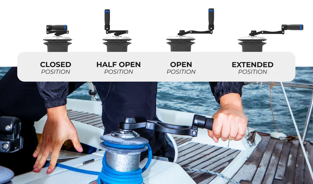

I think I saw some pricey, folding winch handles that allows for some adjustment in the handle length
