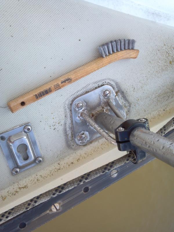

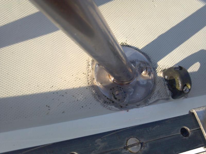

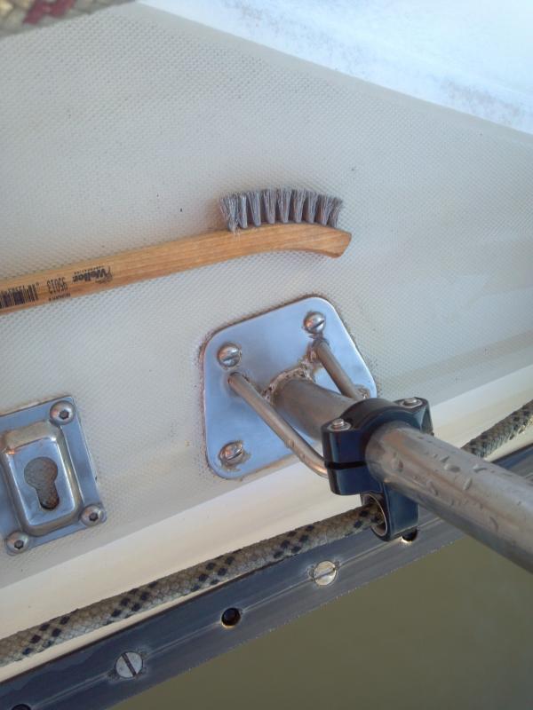

ive posted this before in other threads...
get a small stainless steel wire brush from the welding store.. or home depot and lowes carries them also in the tool section.
you can use it WITHOUT any solvents, or with solvents, your choice.... the fine brush will NOT scratch or damage the gel coat but it will quickly erode the silicone away.
and it can even be used safely on some paints, but in any case, it is way less damaging than a scotchbright pad...
because of the stainless bristles,it WILL cause a dark residue to form while scrubbing, but this can easily be wiped away with alcohol or other cleaner.
and to clean the area of any unseen silicone residue, you can use 99% rubbing alcohol to remove it, or common starting fluid (ether)....

here are a couple of pics of the results around stanchion bases...
the brush also works good to remove the scum from old teak before sanding.... I scrubbed it clean, but im not going to sand it... too much work. the picture shows it a few days after scrubbing, but without oil... it was gray and and a bit mossy at the edges before I applied 3 minutes work scrubbing it clean. we still have a lot of clean up to do, but we had to get a few years worth of growth off of it so we could see where to start. it already looks so much better than it did...
