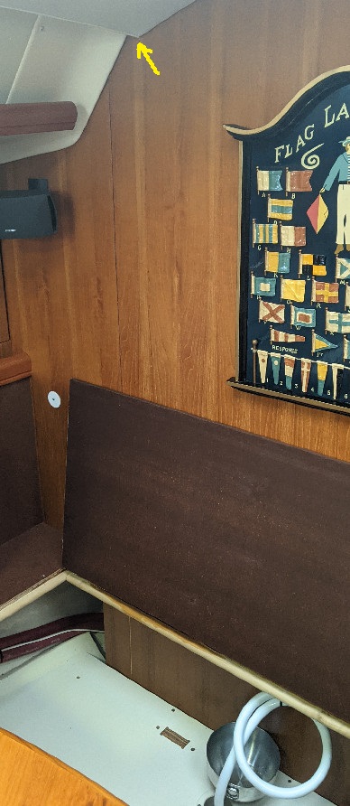

It has been raining very heavily for several days now in the Portland area. I was at the boat this morning doing some work in the compartment below the forward dinette seat and I noticed a small puddle of water on the floor. I shortly discovered that there is a small leak somewhere that is allowing water to run down the wall behind the forward seat and make its way into the compartment below. I have attached a photo with a hand-drawn yellow arrow pointing to where the water is entering from the ceiling.
Based on the location of the entry I suspect that water is entering through one of the deck penetrations around or near the mast. I'm looking for some suggestions as to how to go about tracking down the source and then, ultimately, stopping the leak.
I can see how to take down some of the plastic moldings in the corners but it's not clear how to take down the ceiling headliner. Does anyone have any insight into that?

Thanks. I did spot the mast wiring access plate, removed it and felt around inside as much as I could reach and didn't feel any moisture. It has been a bit drier than it had been when I first discovered the water incursion so I may have to wait for another very wet spell to investigate further. My fiber optic camera might be helpful for peering into small spaces.

Finally! The leak has been located. The water is coming in at the forward outer corners of the two deadlights located about amidships. I've found a couple of posts about re-bedding the deadlights using Dow 795. I wonder, though, if there may be something I can do as a temporary measure to halt the intrusion. Suggestions?
