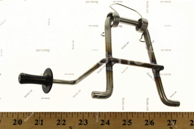

I doubt the part I mentioned will fit your older 9.9hp. Here's a picture in case that helps. Maybe you could rig a spring to accomplish the same thing, keeping the stopper pulled up so it engages automatically when you pull up the motor.
