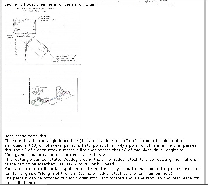

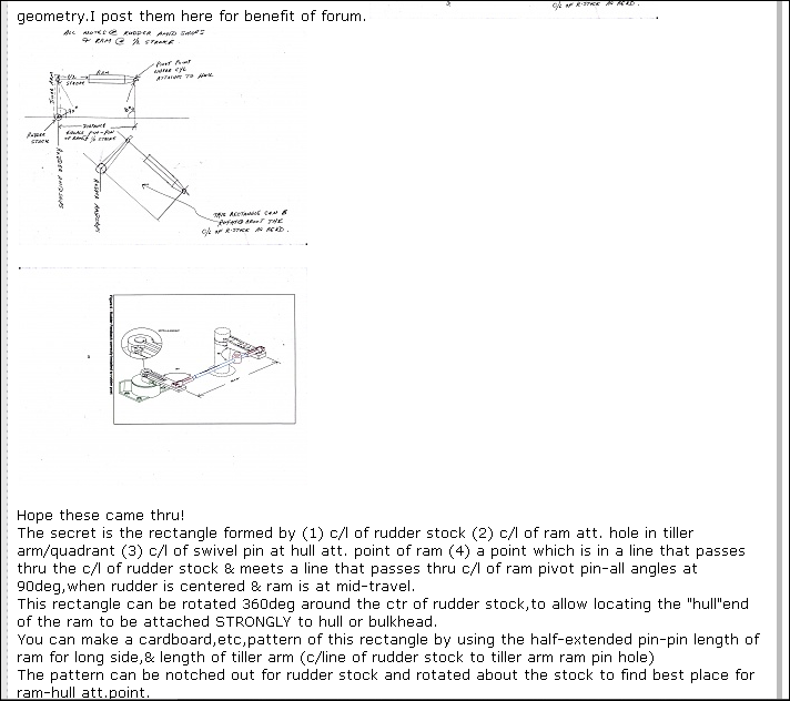

The Raymarine Type 1 Linear Drive (M81130) has a 12" stroke. The mid stroke point (rudder centered) is 6" from tiller arm & 6" to fully retracted.
If you use a tiller arm which is 6'' from center of rudderstock to the heim/rose joint attachment of the ram &
fix the back end of the ram to the vessel so that a rectangle is formed(4 corners at 90deg),then
full 6" stroke from rudder center to ram fully extended or retracted will give you +/- 45deg of rudder.
If you shorten the tiller arm,you will get more than +/- 45. If you lengthen the tiller arm you will get less than +/- 45 deg.
IMHO-the ideal in this case is +/-45 deg.
Note: You should fix mechanical rudder stops before +/- 45deg,to prevent full extension of ram.
See att:
