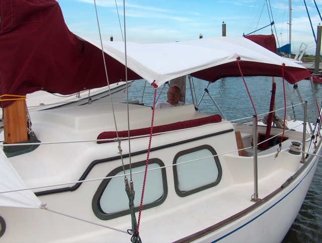

I live on the Texas coast. Today was 96 degrees. I use Z-Spar 2015, and COVER the tiller when not in use.
Actually I have sunbrella covers over all the brightwork I can possibly cover. Note the covers on hand rails and tiller
