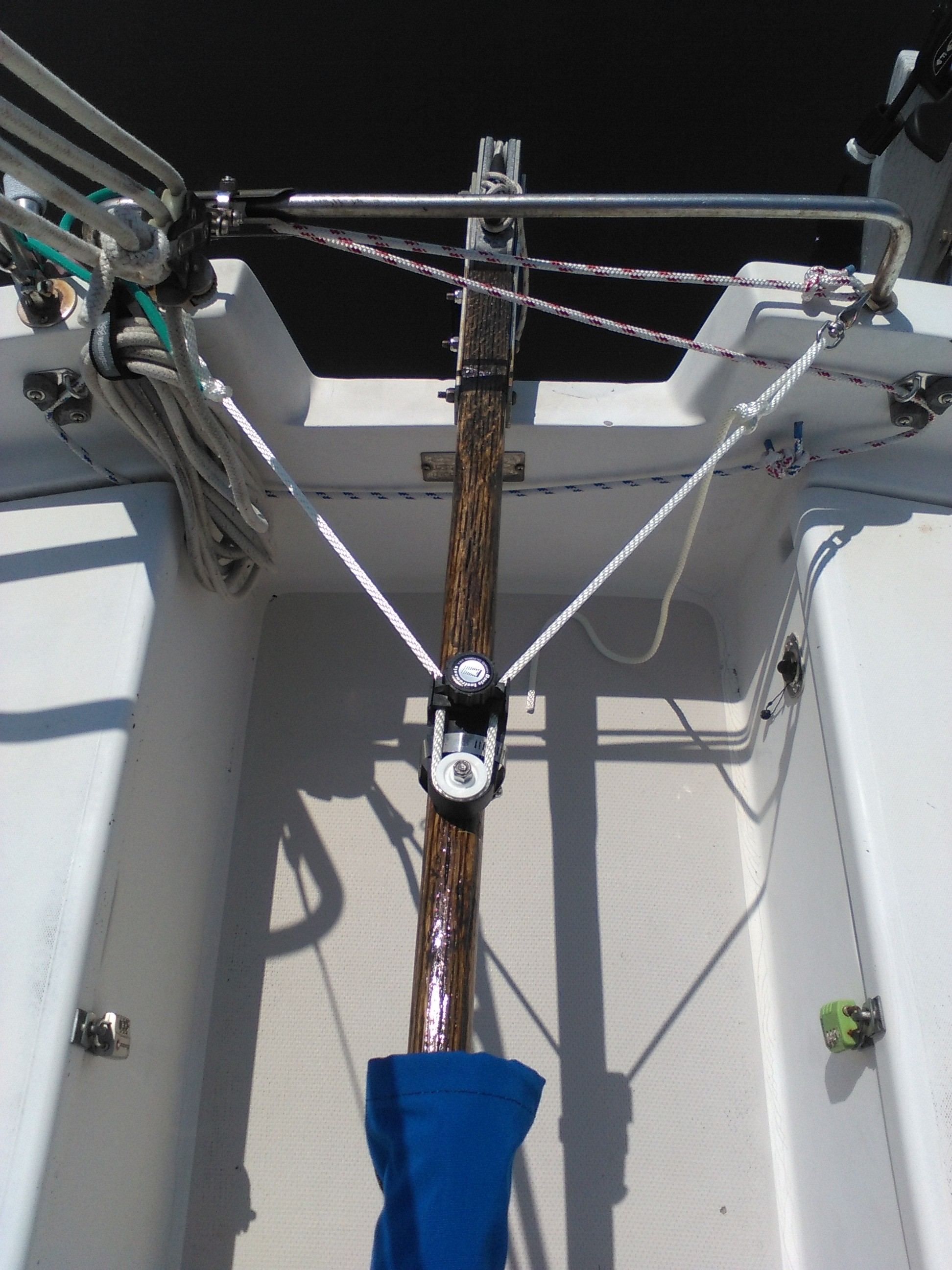

Awesome idea using snaps on the ends of your Tiller Tamer rope Jacktar!! Why didn't I think of that?? Thanks for giving me another idea for speeding up the rigging and de rigging process. PS: The Blue Angels put on one awesome airshow down there in Pensacola this year (as they do every year), were you out on the water in that massive fleet watching the show?

I have a tiller tamer set up like Jacktar, with snaps (we trailer sail). I almost never have to mess with the tension knob. set it and forget it. I keep it loose enough to steer, but tight enough to stay where I put it and have never had a problem with it moving wile I do a tack or grab a cold drink etc. I don't think I'd like having to lock and un-lock it all the time, but I guess it's whatever you get used to that works.

I do agree with this. I used cam cleats on the ends so I can quickly release and re apply the tamer. You are right that with it tight you can't feel much but as soon as I pull the lines out of the cleats it's like it is not even there.
OK, but now you're using the cleats like a clutch. Which is kind of the point of the tillerclutch, you leave the line tight and there is zero friction and great feel, but tap that lever and it grabs the line and holds the tiller in place.
And with the tamer, a tight line generates a ton of friction as it makes the rounds around that friction wheel, even if it set loose.
Jan 15, 2016
3
Catalina Capri 22 Fin Keel Tall Rig Rockland, ME
Right I see what u mean now. I that the tamer that's why I'm using the line clutches because of the friction of the feeder wheel. I like the idea of the tiller clutch. I may look into that option instead. That way I can bypass the stern clutches. The tamer that I have almost feels like power steering in a car. When I have the rope clutches at the end on I do loose a ton of feel. Which I like when docking but am not a big fan of under sail.
