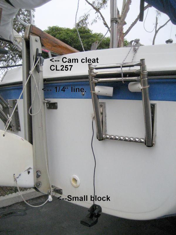

My Auto release cam cleat was also mounted on the side of the rudder channel and had a small block a the bottom.

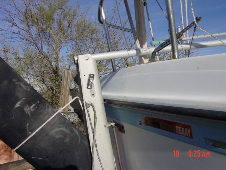

Our boat (26S) came with a stainless cable that is covered and it works fine. You could make up one of these at a WM or a rigger or if you have a swage tool yourself. You swage a loop in both ends and use a large SS washer and a SS bolt down on the rudder to secure the cable there. Works very well.
I've since replaced the line from the cable that goes to the cam cleat,

No the loop at the end of the cable doesn't go down into the shaft. The cable is sized length wise to prevent that.
I tried to find a picture of how it is hooked to the rudder with no luck. Our rudder is an Ida Sailor and there is a 1/4 inch bolt through the rudder where the cable connects and it just rides against the side of the rudder and is held there with a large SS fender washer. There is a nylock nut on the bolt so there is a little slack for cable movement,
