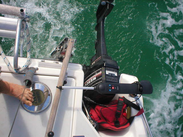

fwiw, I have a TP10 (simrad) and have a light tiller (balanced rudder).
I mounted my TP much closer than the mfg recommended and have no problems. its plenty strong for my little boat.
that said, I'd get the larger, and get new, then mount where you wanted it. (closer than recommended). assuming that is the best place for it. (that's the only reason I mounted it closer to pindle. its was the logical place it fit)
and fwiw, I have it connected to #14 wire, but with a cigarette plug, that had like #24 wire (very very thin).
the only problem the TP10 had is when the batteries are too low.
-YMMV
http://i64.photobucket.com/albums/h169/ftldiver2/MACGREGOR/PC160017.jpg
