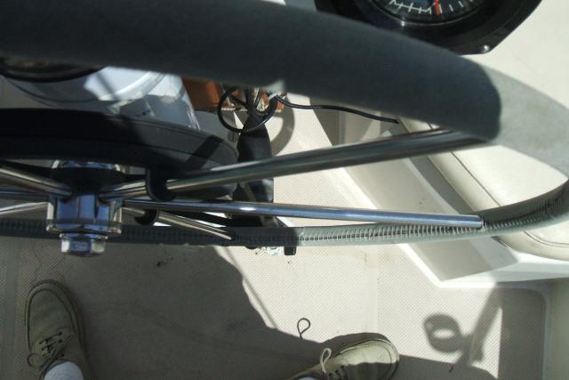

Wheel steering was added to this boat after production. The head of the rudder post is visible in the picture just below the cooler where Jeannette is sitting. Since tiller pilots are so much cheaper, I was wondering if I could make a tiller that came off of that head directly to port, 90 degrees from where a normal tiller would be positioned. Then have the tiller pilot mounted there parallel to the centerline of the boat.
(1) Is it possible to mount tiller pilots this way? I read a manual and it didn't say it was or wasn't possible. I have never played with a tiller pilot, I don't know exactly how they work.
(2) Will there be too much friction because of the cables and mechanism of the wheel?

Hermit, tiller pilots must be easily accessible because the only way you can disengage them is to lift the arm off the connector pin on the tiller. There is no clutch. You cannot steer manually while the AP is engaged.
The device you are talking about regarding wind vanes is called a servo. It's like power steering, using water pressure to assist conversion of the subtle wind vane movement to a strong enough force to control the rudder.
