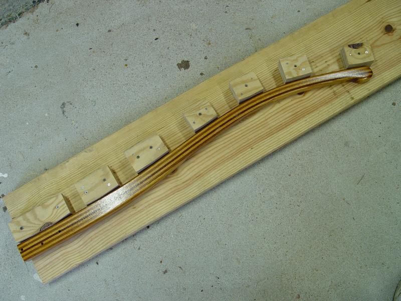

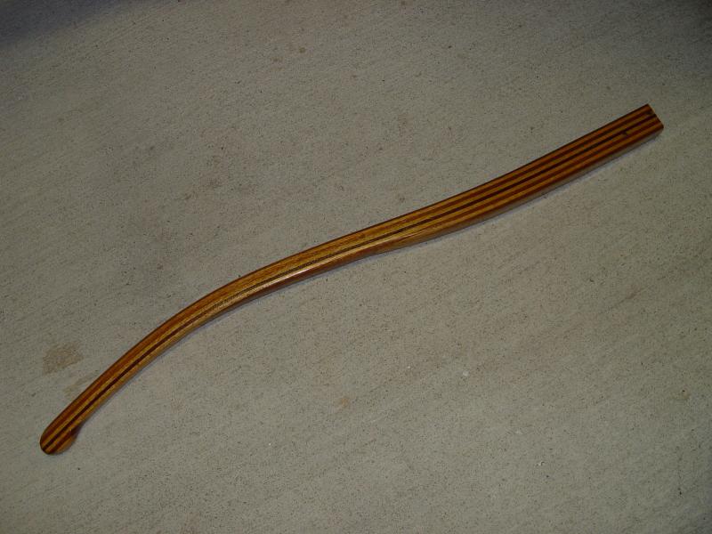

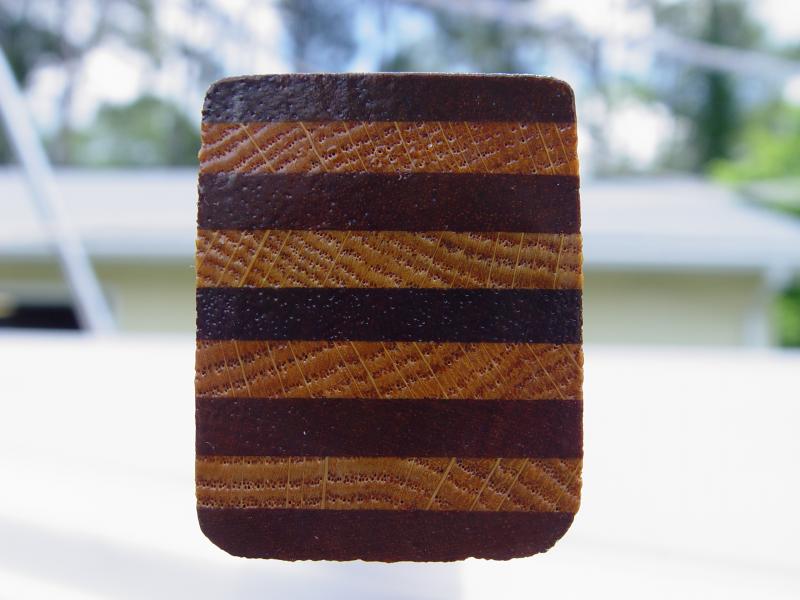

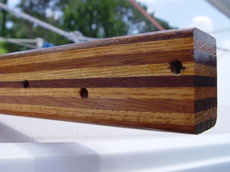

I was having some of the same problems with my knobby knees getting banged up under the original tiller that came with my boat so I went out to the shop and got busy with some red oak and mahogany. I've looked at all those pretty laminated tillers everywhere and decided to build my own, a little longer and with more curve in the end to get it over my knees. I cut my stock oversized, glued up one ply at a time and then shaped it to my liking. It's been one of the best improvements I've done to my boat so far.
