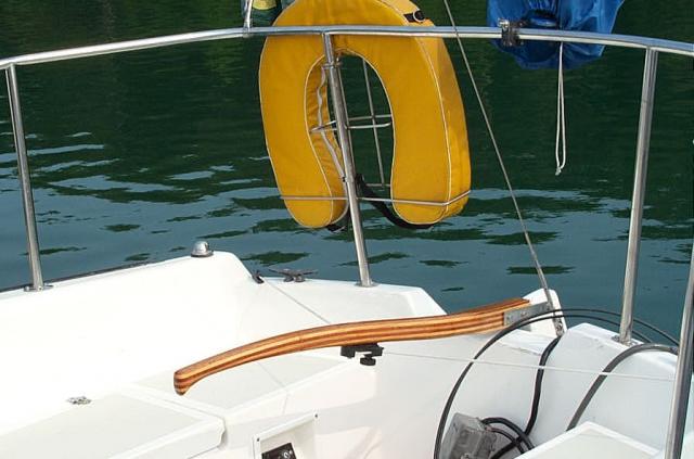

Stu: I don't know what the original looked like, but its not important. What is important is that you get a stick that you are comfortable with. When I bought my Oday 23, the previous owner had made a straight tiller; it was fine, but I found it constantly hitting my knees and the knees of anyone sitting across from me. I decided to switch to a curved model. H&L Woodworking makes really beautiful replacement tillers; you can get them thru West Marine or Defender. I chose the H&L model 112f because of the nice curve. The tiller is now easy to reach and never bangs into my knees. It also looks bitchin'.I'm going to need a new tiller for this 23, as its rotten and the foward end is snapped off. Can somebody tell be the correct length? did the originals have a curvature? Are there prefabs sold by the marine stores? Thank you
