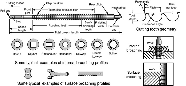

If you're replacing stanchions, I recommend square holes in the base with carriage bolts for fasteners. The heads of the bolts will be smooth, the square shoulder of the carriage bolt keeps it from turning, everything is done from inside.
23,007
Do they still make square hole drill bits? I think there was a manufacture back in the 40's.
dLj
Mar 23, 2017
4,345
I've owned these for wood, but never seen one for metal... Got a picture? I've only ever either punched square holes or milled them...
dj
  • Ha
Joe
Jun 1, 2004
8,181
Ok, I'll bite. How do you make a square hole in metal?
If you read my post, I said "if you're replacing stanchions".... which means you would order the bases with square holes. This is an option with garhauermarine stanchions.... don't know about other makers. Regarding the "how" I would imagine they use a stamping press with the appropriate die. There's nothing uncommon about "drilling" a square hole in metal to accommodate a carriage bolt or other square stock. The technique is called broaching, I believe. You might google it for more detail.

...The technique is called broaching, I believe. You might google it for more detail.
I didn't mean to challenge the idea of a square hole. I just didn't understand how it's done. I think it's a great way to handle the two person stanchion maintenance problem.
