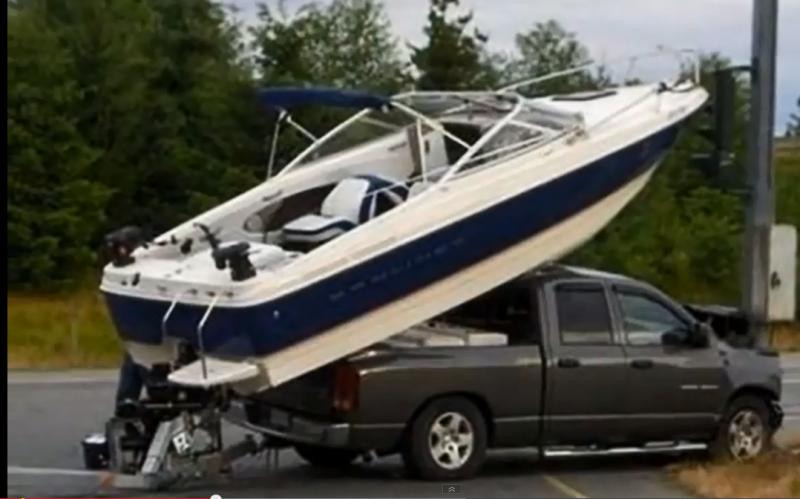

Or even a hard break or a head on.... if the pressure from the boat on the stop causes the stop to fail....
Hey... a roof rack for your ski boat... nice.
