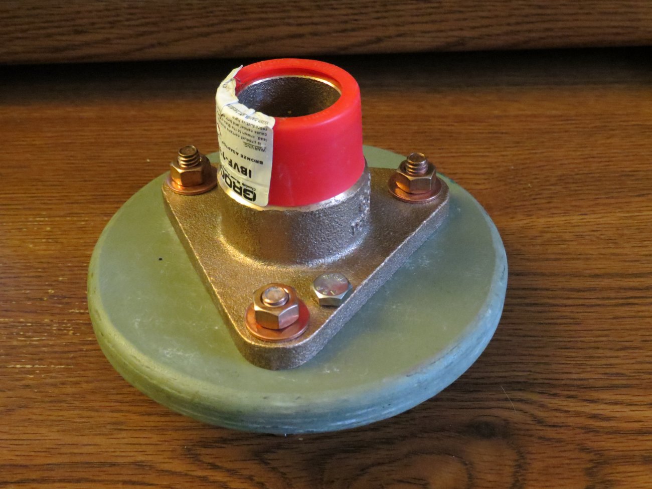

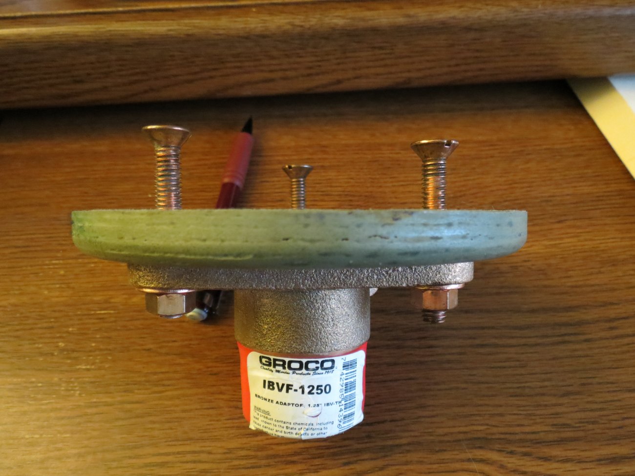

When I replaced my galley thru-hull and reworked my seacock a couple of years ago I used a circle of 1/2" fiberglass epoxy board. I don't know the source because a friend who was re-doing a few of his thru-hulls gifted me this piece. I would expect any decent boat building business to have this. I think I remember that my friend needed to buy a 2-foot square piece that yielded many thru-hull backup bases.
After grinding the mounting surface to get to clean bare fiberglass I bedded it with thickened West System epoxy. I also added the pictured Groco adapter that adapts the NPS straight threads from a thru-hull to the NPT tapered threads on the ball valve. Slick installation; I will do it again if needed.

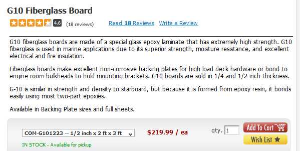

I checked the SBO store, but I did not find the board.
But it is at Jamestown Distributors-
Did mine exactly the same ,the board is G10fr4 Garolite and is available in any size or thickness from Mcmaster Carr in U.S and it is also what is used for your drive shaft tube .I used 1/2 " for my thru hulls and transducers.Used west epoxy mixed with 404 .
