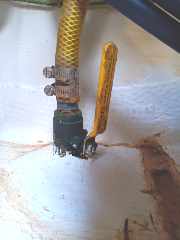

When I first inspected the thru-hulls, I found something like this inside the hull.

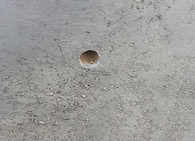

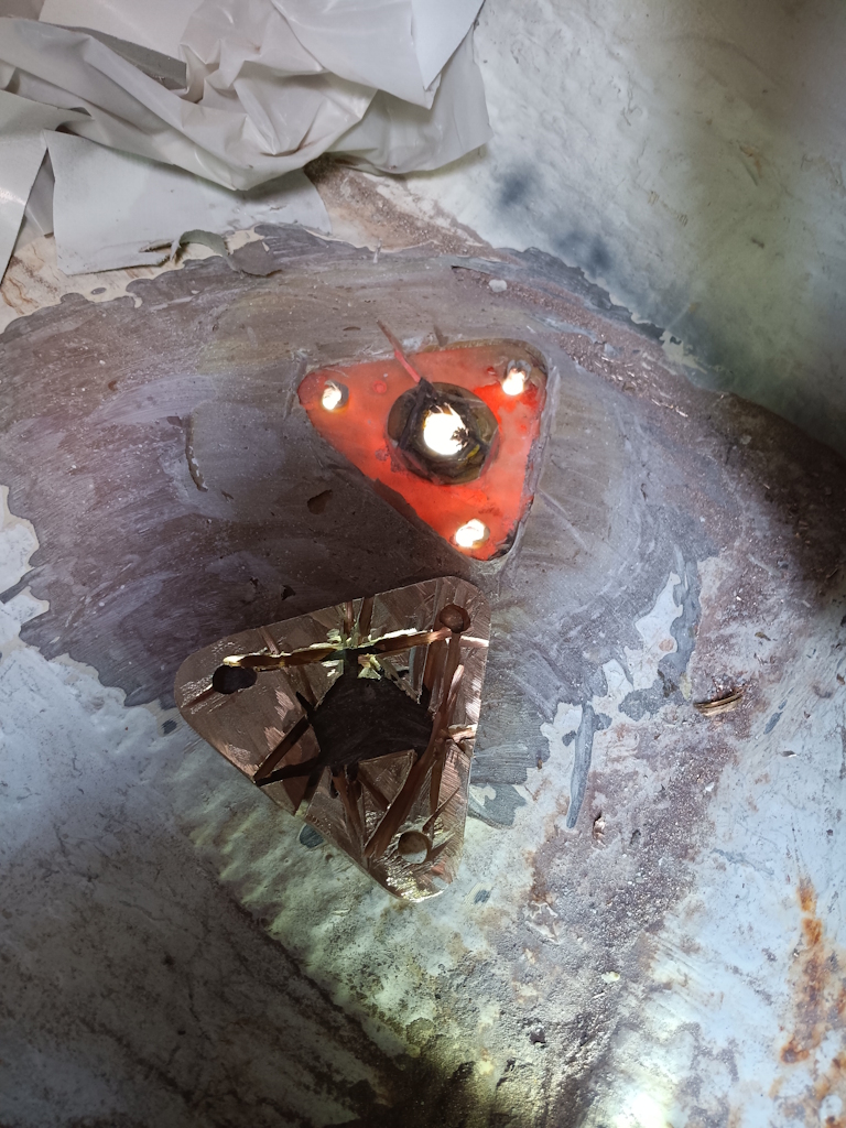

The outside looked like this. The only thing I could really see of their condition was what appeared to be dirt/corrosion of the balls when I aimed a flashlight up through the holes.

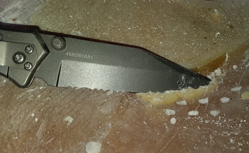

After the first discussion, I thought I'd chop it out piecemeal since I had no idea what was under that mess. I started with an oscillating multi-tool trying not to destroy the valve but I was only getting small pieces at a time. I then got my 4" angle grinder with a cutting wheel and cut larger chunks away, alternating with the multi-tool because of the clearances. Once I got down far enough, I noticed some bronze showing where there would be a flange & bolt. I hadn't noticed any bolt "depressions" on the outside of the hull so I sanded away the bottom paint and found this.

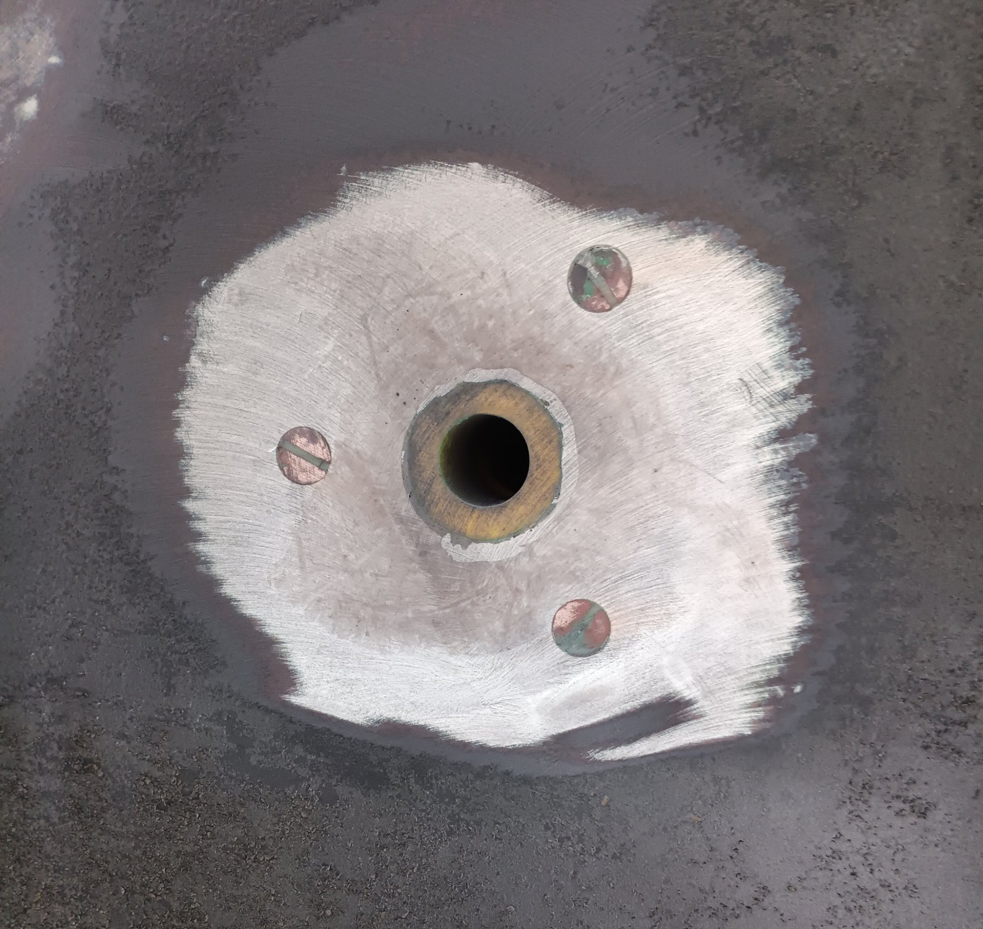

At this point, I had a better idea what I was working with and put a grinding wheel on the grinder and worked my way down to just about level with the hull. The flange was still visible and the valve was in the way so I cut it off with the cutting wheel as close to the hull as I could get. Then I used the grinding wheel to grind everything away even with the hull. I found that there was still a substantial amount of metal in the flange and the bolts (with the nuts already ground off) stuck to the hull. First I tried cutting the flange in pieces using a cutting wheel and break it out but I chickened out when I had already scored the flange enough times and nothing happened. Next I thought I could pop the bolts out with a drift pin and a quick pop with a hammer. When I did that, the flange broke free and popped out of the hull leaving the bolts still sticking in the hull. I ended up using an EZ-Out (bolt extractor) to break the bolts free from the hull. I'm guessing the threads were epoxied into the hull. I also found that the flange had been embedded in the hull layup about 3/16" leaving a little over 1/4" of hull thickness left and an odd shadow around the hole. It looked & felt like plastic but couldn't get a clear view inside nor outside.

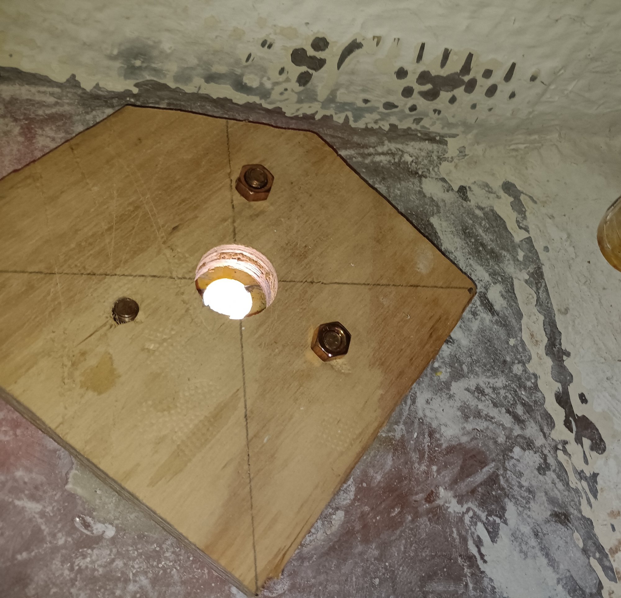

When I held up the old flange to my new Groco flange, the dimensions and bolt pattern were identical so I decided to save the bolt pattern in the hull and just drill the correct size hole for the new thru-hull. I made a pattern with some 3/4" plywood and bolted it in place inside the hull to drill the new hole with my holesaw. (I also used the pattern to drill the G10 I bought for the backing plate.) When I started to drill, this "shadow" popped out of the hull onto the marina pavement. It was indeed a piece of plastic. I'd never seen a thru-hull with a plastic ring about its tailpiece. I was now left with a hole in the hull that was 1/4" wider than the new thru-hull.

To preserve the bolt pattern, I wadded up some plastic to about a pea size and pushed them into the bolt holes from the outside. Once I finished repairing the hull, I could then re-drill the holes from the outside with the old holes as a guide. I ended up using 2 layers of chopped strand mat alternated with the first 2 of 8 layers of 10 oz cloth to bring it fair with the hull. I let that cure for a couple days before I went any further because I was using slow hardener, a newbie to epoxy work, and overly cautious.
At this point, I dug the plastic "peas" out of the bolt holes and re-drilled through the newly patched hull. From there, I could re-install my template and drill the new thru-hull hole to the correct size. Now I was ready to finish the job.

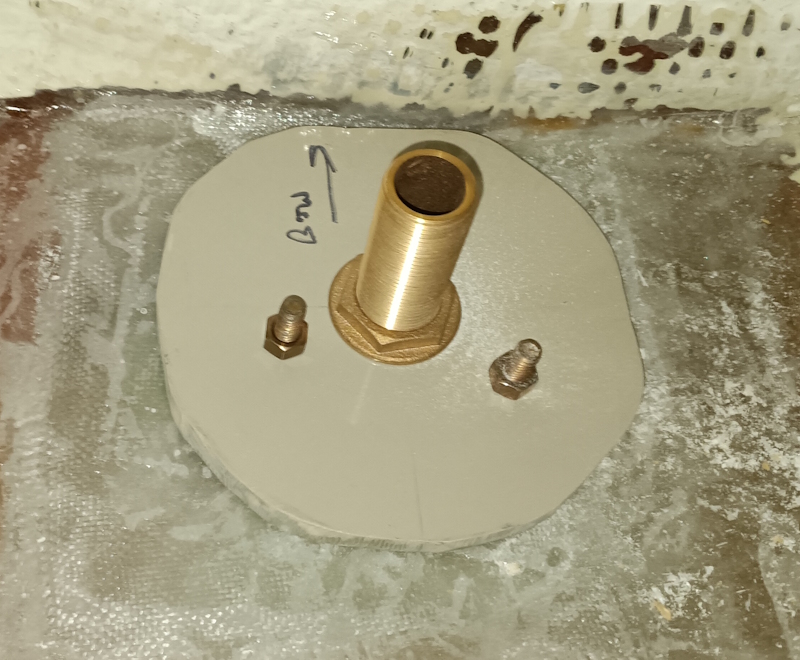

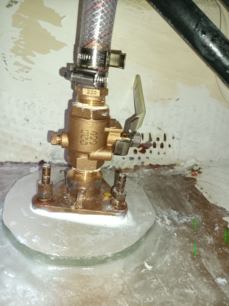

I trimmed and scuffed up my G10 backing plate using the cutting wheel and flap disk. (No big holesaw for the G10 at those prices.) I beveled the edges of the G10 backing plate to minimize hard spots, did a test fit (above), and then epoxied it to the hull using a mixture of the 404 high density filler and the 403 microfiber filler. To keep everything in the correct position, I used some bolts and an XL thru-hull I had accidentally bought when I first started out. It's been a handy guide as I fit things together without messing up the final pieces. All were waxed up to prevent epoxy from sticking.

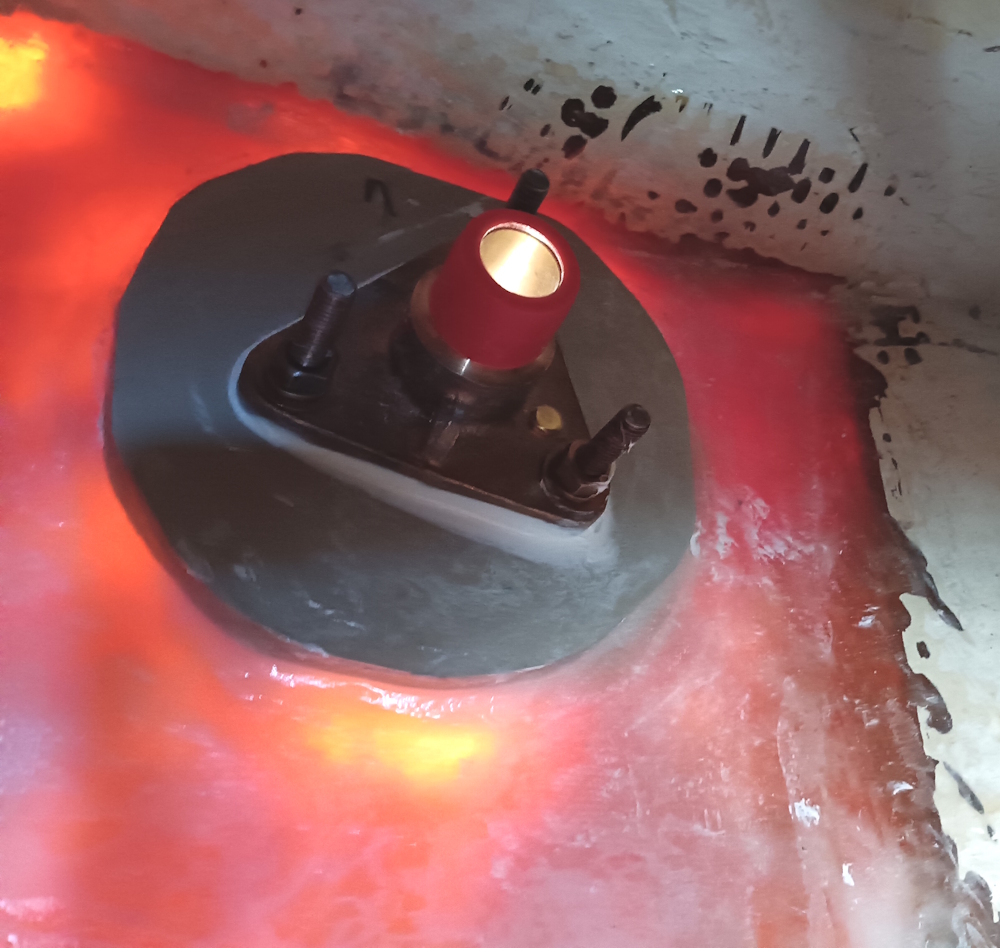

I installed the flange using Sikaflex 291 on both the bolts and the thru-hull and tightened everything up. Then I let the Sikaflex cure for a day before I screwed on the valve and hose adapter using Permatex thread sealant. I used a similar sealant when I worked at the power plant and it made a great, leak-free fit on systems that ran up to 2000 psi.
