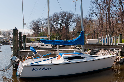

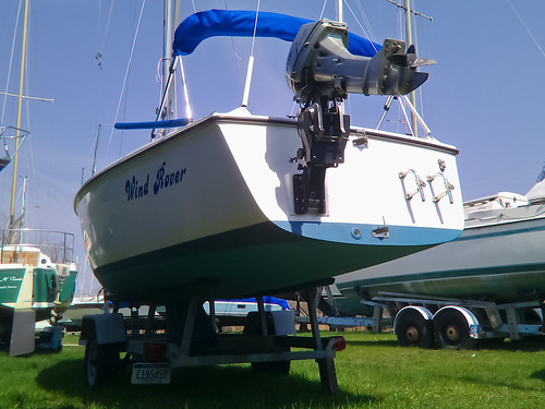

For reference, here's the new engine and mount right after I installed. I would like to put the throttle and shift cables thru the transom on the port side up near the top.
http://www.flickr.com/photos/paladin27/5673910477/
You can see the remote cables in this photo if you click for a larger photo.
http://www.flickr.com/photos/paladin27/5695582137/

I'd probably just drill holes where you want the mount to attach. Drill large enough for appropriate sized rubber grommets and seal with 4200. JMO. Good luck.

Tough one. Where are the control handles mounted, and how high (or low) do you want the through-hull?
The obvious need is to ensure water doesn't get between the transom and rear wall of the cockpit, and thus into your bilge. I'd run the hole through as high as is reasonable, to keep splash and waves away from it. Maybe get a piece of plumbing PVC large enough to handle the cable connectors, and fiberglass it in place, using the glass to waterproof?
If by 'dog house' you mean those stainless steel hoods that cover holes like where the battery charging line penetrates, I doubt if that alone would work for a big hole. Water would splash up from below, and without a tube of some sort to seal water from getting behind the transom, would end up in bilge (lazarette). With such a tube, I wouldn't worry too much about keeping all water from entering hole, as if properly sealed it'd just end up inside cockpit.
