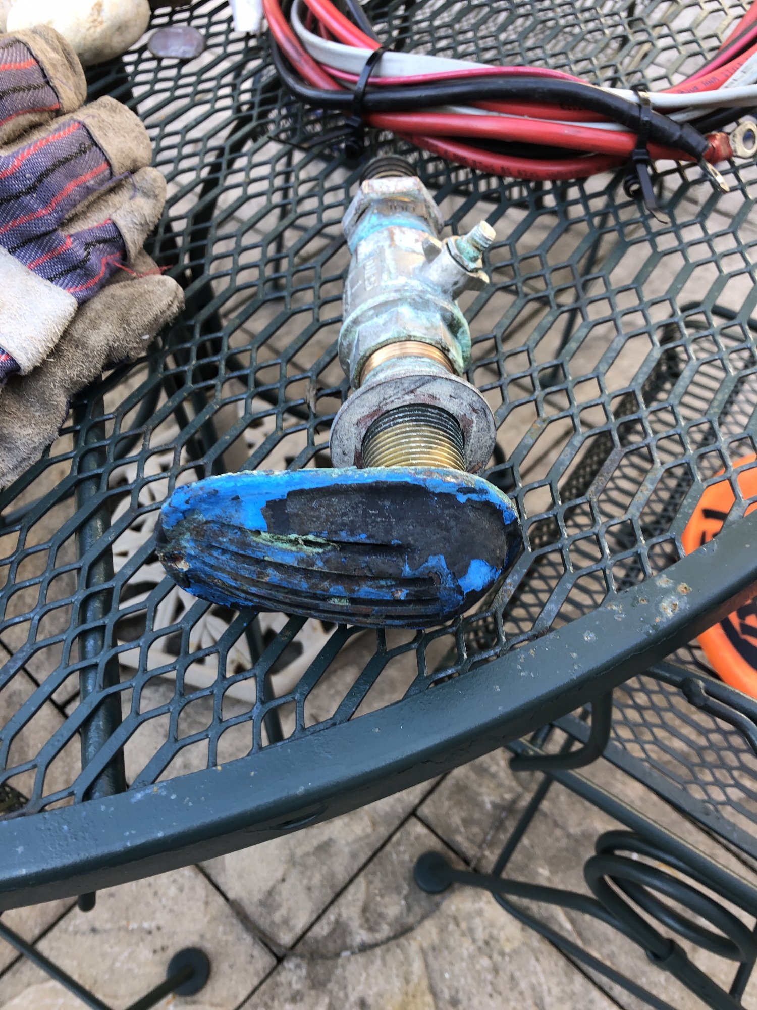

So I am continuing my replacement of a few they hull fittings and seacocks. My engine has an external strainer....... what are the feelings of these. All previous boats did not have these and I see limited amounts in yard.
Thanks
Greg

I would never install the one-piece strainer and thru-hull like the OP's picture shows because it is too hard to clean out. In fact I removed onefor my A/C intake. In post #2 above, a previous thread was referenced and in that thread I have pictures of my hinged-cover external strainers. Since installing those strainers with holes, not slots, my internal strainer receives almost nothing. I literally clean my internal strainer once per season and only take out a couple short pieces of grass.
So the bottom line is that not all external strainers are equal. As Stu likes to say, "Your boat, your choice".

I have never had an issue with my engine intake clogging..... however at the end of every season clean all sorts of mussels and barnacles out from inside the strainer. Also as Maine says it’s easy to clean from the inside. On my ac intake it will clog after a couple of days as we are not moving.... this fitting has no external strainer. I take the hose off holding it above water line, use my dinghy pump and blow it clean. So think I will stick with my first thought and trade for no external strainer.... thanks!
