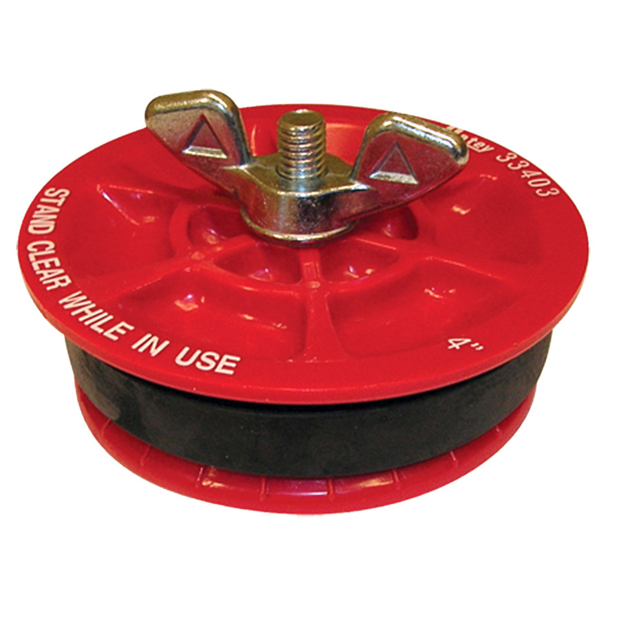

plug.jpg What size is the thru-hull? What brand is the valve? I would get a plumber’s test plug (Lowes/Home Depot or plumbing supply) of that size, take a quick dive over, clean the thru-hull opening and install the test plug. Then back inside you can safely try some of the methods mentioned or just take the hose off, remove the valve and take it to a bench where you can work on it. If you cannot repair the valve, you’re all set to install a new valve and be done. Good luck with it.
