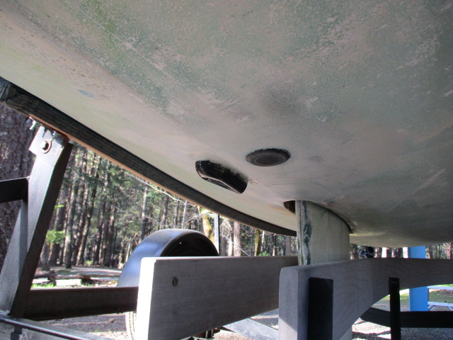

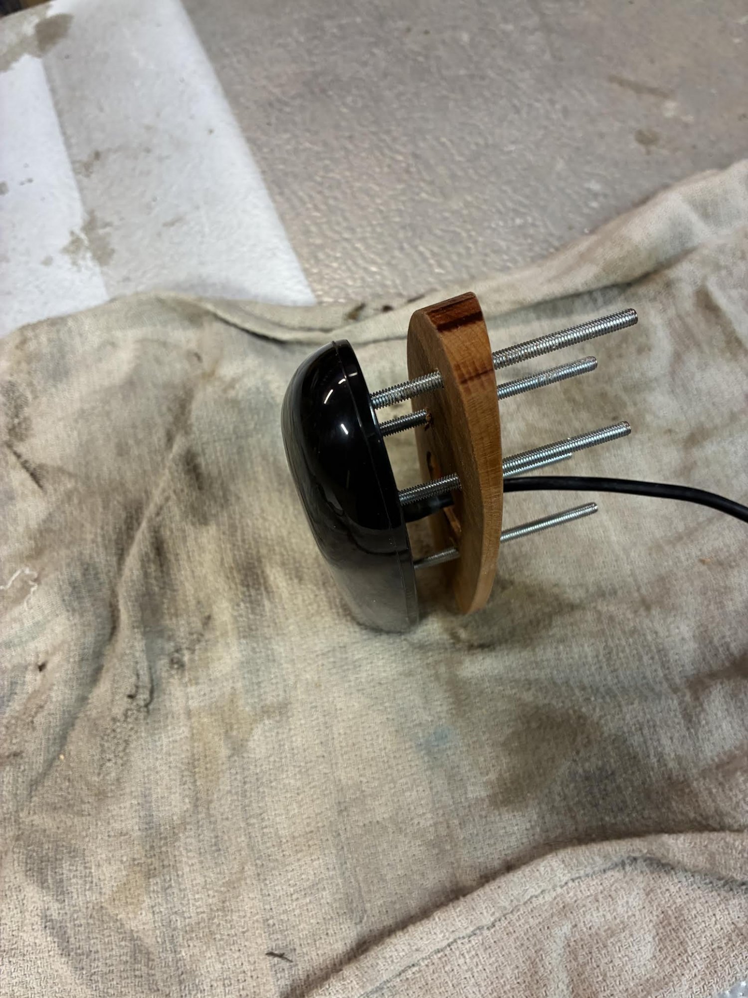

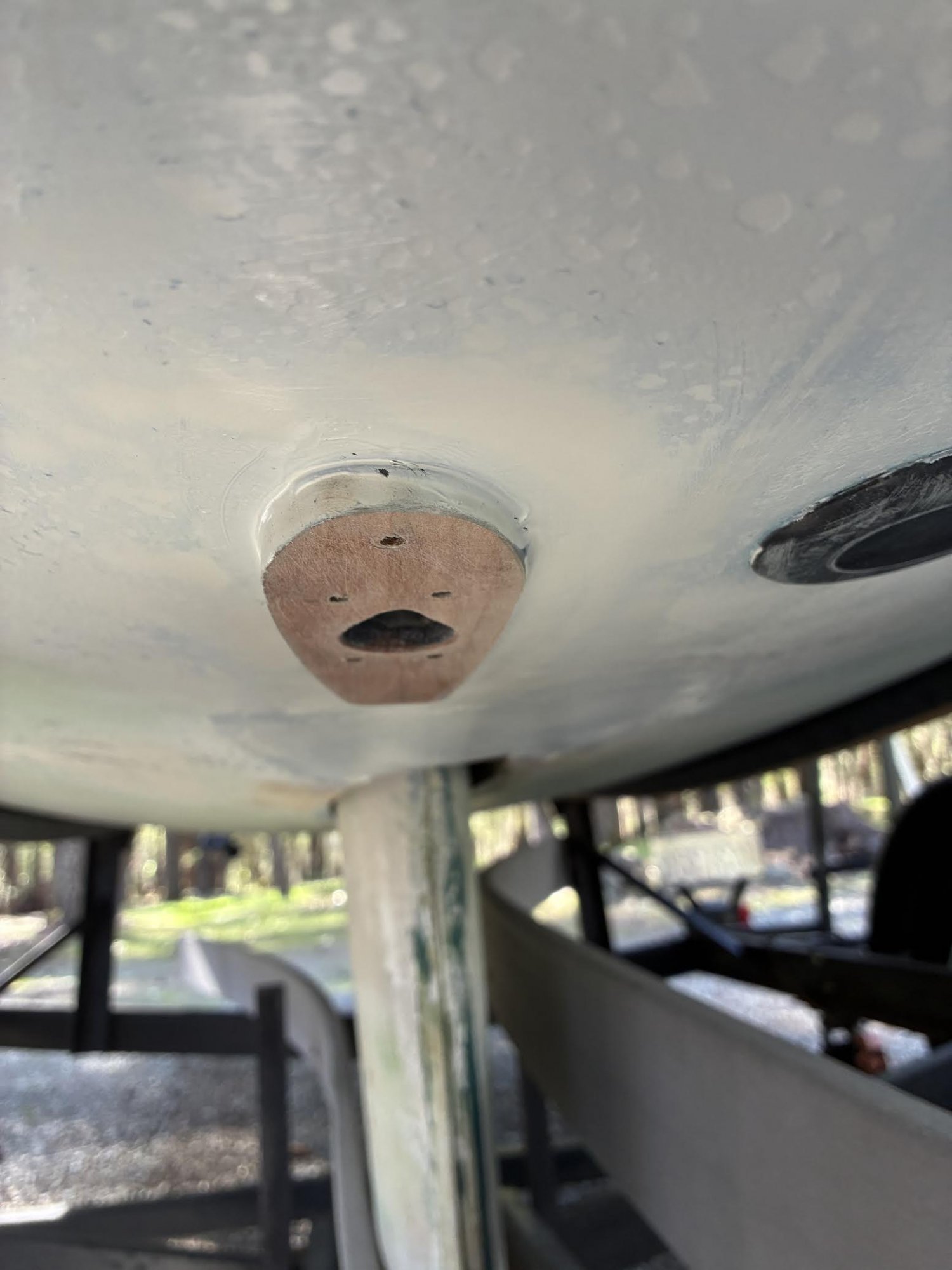

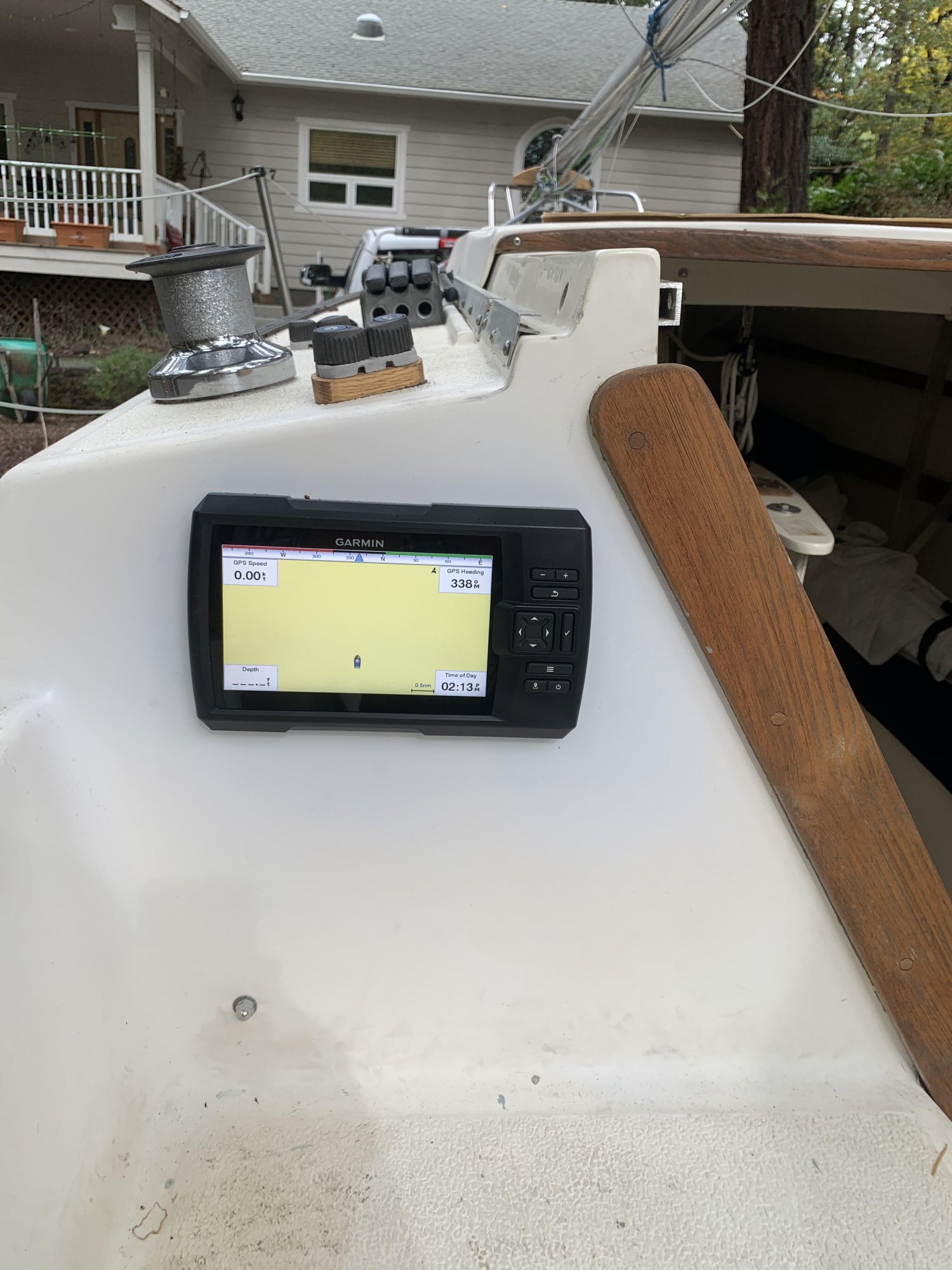

Garmin Striker Vivid 7 installed over the winter. they come with a bracket to mount the transducer on the transom. the whole package was under $400.00 and suites my needs well...... except due to the upswept stern of my boat I suspect the transducer would come out of the water much of the time when under sail so I went looking for a through hull type. Yup, no problem, we can fix you up. that will be $450.00 please.:facepalm:. it does exactly the same thing as the transom mounted one as far as I can tell. sonar, depth, temp. WTF!. a replacement for the transom mount transducer only sells for about $90.oo!!...... anyway. where there's a will there's a way and it cost me next to nothing as it's the transducer that comes with the unit. just mounted a bit differently :). blast away! :beer:.

I can't tell whether it is mounted forward or aft of the Keel/centerboard.
They give specific installation instructions so the transducer sits in the best water flow for good transmission and reception. Follow the instructions to the letter, or do not expect very good accuracy.

How did you waterproof the wooden piece? Looks well done, however, for a thru hull fitting it may not be the best long term solution. Over time I would keep a close eye out for leaks. Unless its perfectly sealed, and stays that way forever, the wood will eventually allow leaks. You may consider Starboard HDPE material if it gives you problems.

First soaked the wood in polyurethane to full absorption. after that cured I epoxied it to the hull. when that cured I set the transducer with liberal beads of 3M Bedit. trimmed the squeeze after it was bolted in place and put down a coat of epoxy from hull to 1/4" down the transducer so all joints are covered. beyond that I filled the hole from the top with RTV silicone. :thumbup:
