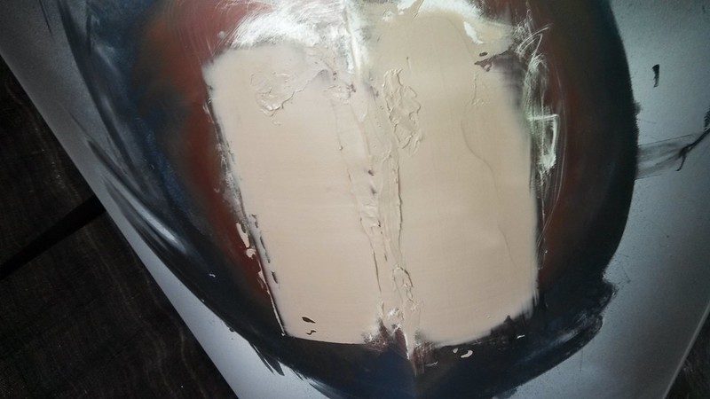

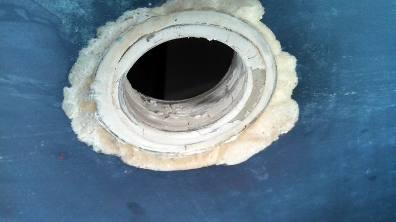

Thought I'd document the process of removing my through hulls and filling in the holes. Last summer, while we were on our cruise to the San Juan Islands, we discovered that we had a leak around the paddle wheel for the old Standard Horizon speed/depth meter. I managed to slow it down from a couple gallons a day to a couple cups a day with some MarineTex, but I obviously can't put the boat in the lake for the summer with a leaky hull.

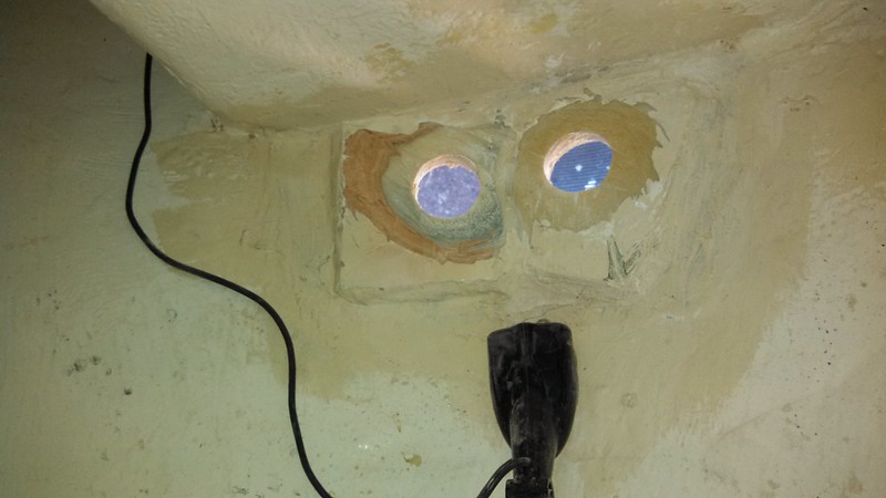

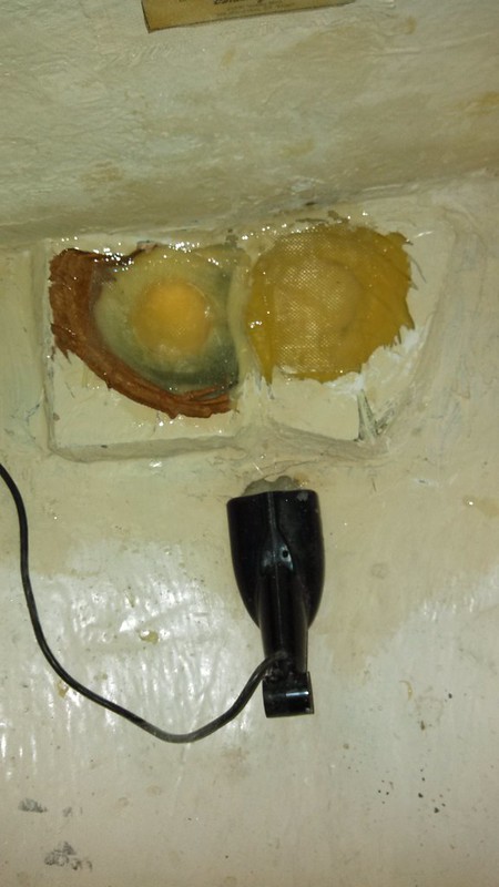

Today I managed to remove the paddle wheel, which is where the leak during our San Juan Islands trip came from. Once I got it out I could see that there was an area where the 5200 had a bubble, which is probably where the leak came from. There was also still some water between the gaskets of the paddle wheel unit when I pulled it out of the fitting. Kind of surprised at that, but just another reason to go ahead and get rid of the whole thing. No holes below the waterline is a good thing IMO!

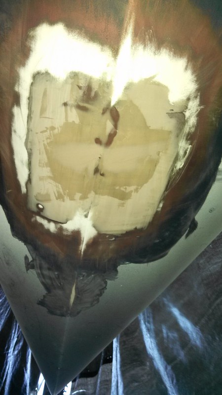

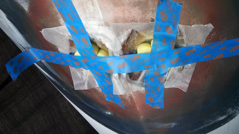

The depth sounder head proved a bit more stubborn than the paddle wheel so I left it alone. I'll grind away a bit of the epoxy first, then knock it out. Didn't feel like messing with it today as I need to remove the bottom paint before I start grinding.
I was somewhat surprised to discover that the through hull pads are solid glass layup (13/16"), not glassed in marine plywood. That will make things a bit more interesting since I'll have to fill the holes instead of cutting/grinding out the plywood and working directly on the hull.
![](/proxy.php?image=https%3A%2F%2Ffarm3.staticflickr.com%2F2910%2F14155449465_061eab02f1_c_d.jpg&hash=fad2e40f7a85621b12656bd73c1a366b)
