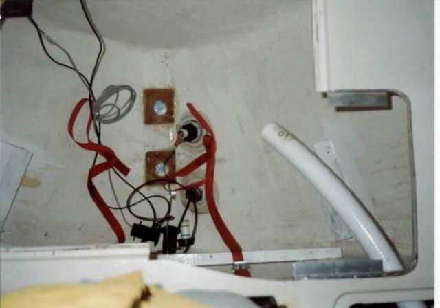

Glad you saved some poor soul a lot of grief. I use just plain old plywood because I soak it in epoxy. I don't think it will get wet, nor swell, nor delaminate. I try to install in flat areas of the hull so that I don't have to shape the block. Picture is where I installed two new Nexus transducers next to the originals(1979). Probably can't tell but the holes have a coat of expoxy as well.
