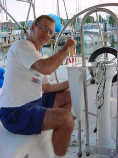

I did it on vacation to our '85 H34
A couple of years ago we were just the first day out on a month long cruise and the shifter plate broke. What I thought was metal was plastic and should have looked into it because the shifter was really loose. Well, it irrepairably broke out on the lake so we stopped at Waukegan and it took four days, but with help from Edson and Larson's in Waukegan, I replaced the dual shifters with a single handle unit. It bolted right in and attached to the ped guard. And you are right, it is a good upgrade because the admiral can dock the boat no problem. It is a good time to replace both cables and I did not think that it was difficult. I can't remember exactly, but the cost was around $4-500. And you can get a housing to put on top of the shifter to hold a knot or depth meter. I did that and glassed in the old ones that were on the bulkhead. As you can see in the picture, I took the time to redo all the wires in the ped. It was a huge mess that needed replacing and organizing into a bundle. If you can do it at your home port and order all the parts you can do the job in less than three or four hours.

Looks good John
...do you remember the supplier for the shifter? Thanks
