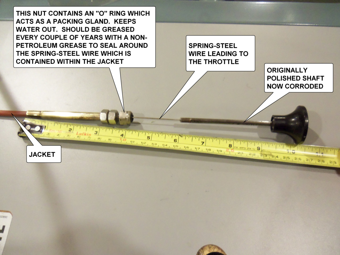

You will find your throttle/shift, stop or etc. similar to the old cable construction shown below :
As previously mentioned, once the cable becomes difficult to move, it's shot. Nothing is going to rejuvenate it because the spring-steel wire and the previously polished SS shaft have become corroded by water getting through the small "O" ring gland which tightly surrounds the SS shaft and forms a seal .............. back when the SS shaft was smooth. Think crevice corrosion on the SS shaft. If you read through the attached literature, you will see that the interior of the jacket is lined with HDPE. Corroded steel does not slide easily over HDPE even when oiled over a 15 foot length. You may be able to find the cable(s) you are looking for in there.
All you've got to do is remember to grease that "O" ring (which grips the shaft) every couple of years and the cable should last forever.
One last note here is : before you invest in new cables which BTW are not cheap for Teleflex, check that the device (throttle/gear shifter etc,) being moved by the cable is not the cause of the resistance to movement which you are experiencing. Obviously a new cable will not help much in that case.

Hate to be a Dougie downer but I'm afraid the damage may already be done i.e. the shaft and internal wire may already be corroded.
But why not ? As I always say, "Start with the cheapest (even free) maybe solution and work up from there." Try polishing the shaft first with 1500 emery rubbing in a longitudinal direction first. Same goes for the internal wire as far as you can go. And as a last "I tried everything" lament disconnect the device being driven and see if the cable is still tight. It's all free.
