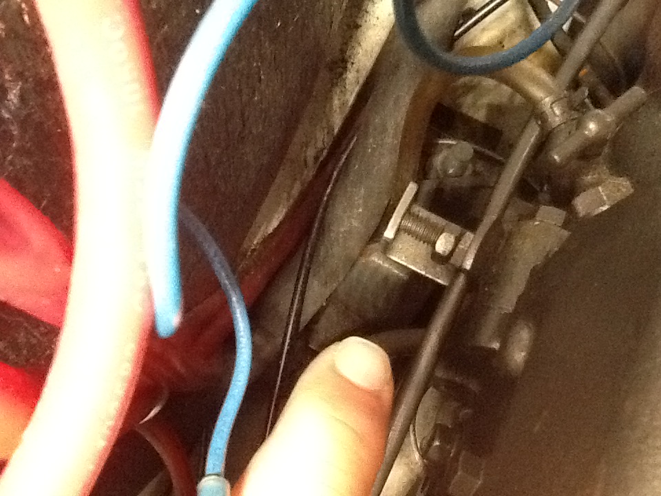

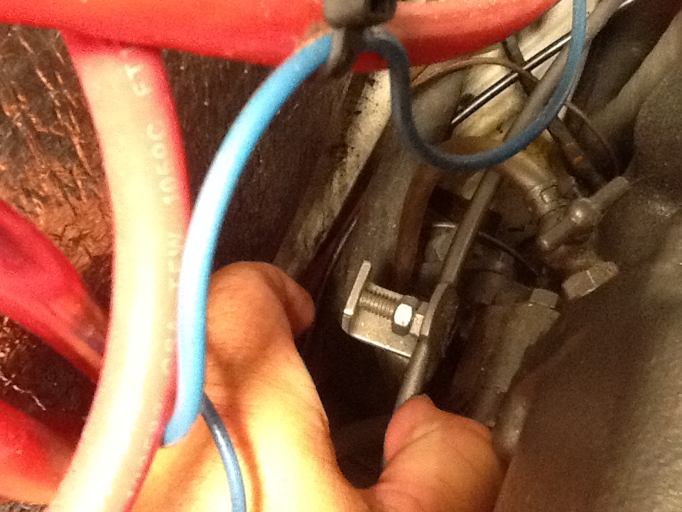

What does this clamp do and what is it called
I have a h34 1983 and with a yanmar 3GMF diesel I don't see this in the manual and it does not appear to do anything.image.jpegimage.jpeg image.jpeg

It appears to hold the outer jacket of the cable stable while the inner rod moves back and forth. But it doesn't look original either, ours is quite different.

It provides resistance on the cable so the throttle doesn’t change settings.

Can the throttle be adjusted if this clamp I loosened or removed or does it just provide resistance?
I am afraid to mess with it.

Confirming what others have said that clamp is to adjust the tension on the throttle, otherwise you'd have to hold it in position against high resistance.

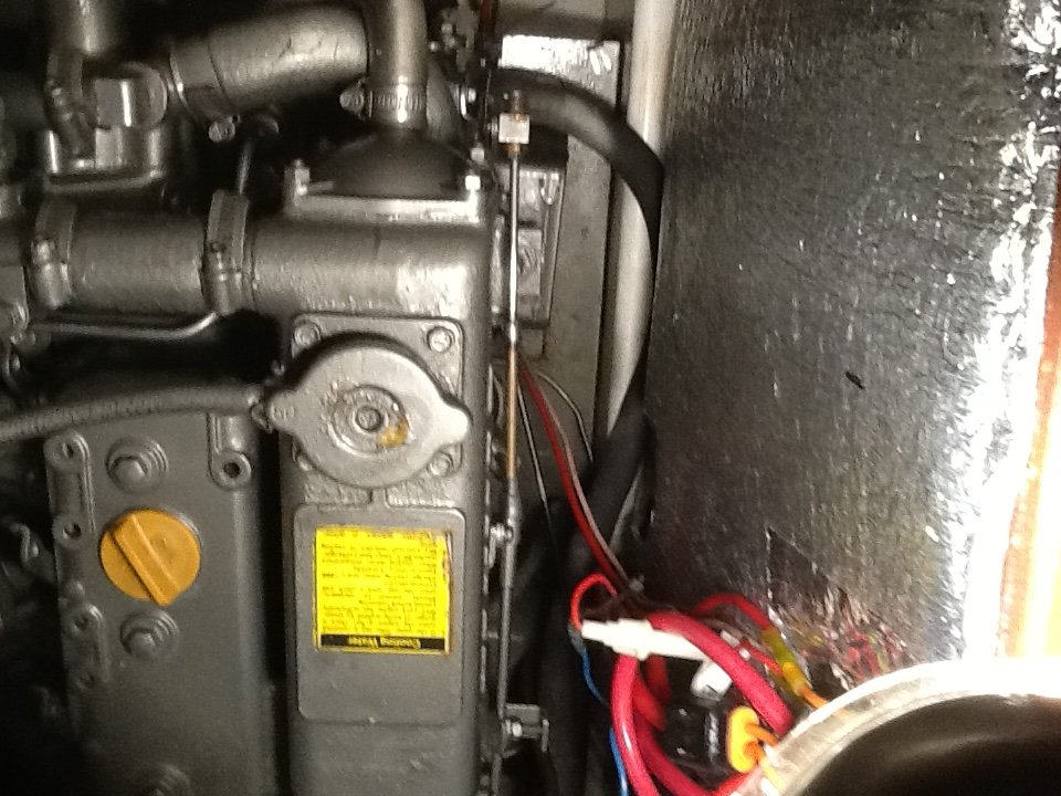

Before you replace the cable, which probably isn't your problem, take the throttle lever on the injector pump, to which the end of the cable is attached, by the tiny brass spring and cable adjustment nut, and move it by hand. Will it go to full throttle position ? Try it with the engine running, can you get it past 2000 with cable disconnected or is exhaust elbow ckoked like a potato in a tailpipe ?

All boat throttle cables I’ve seen are adjustable on at least one end. Look how to adjust it rather than spending $$ on replacing stretched cables. Take god pics of both cable ends and someone here will pipe up on how to adjust it.

I just replaced both shift and throttle on ours yes it was a pain, and no there was no adjustment and the motor end looks familiar on yours and I would bet the lever end is the same. The stroke on the lever determines the throttle range. I purchased the cables from this site
