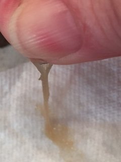

1. We are currently living aboard, for the past year, using fresh water from our tanks, which is municipal water. We do not shower on board. Every couple of days, for the past 6 months while running hot water the aerator will plug up with a substance that looks just like (sorry) snot. It behaves like snot but stays in one piece better. We clean it off the filter screen and continue on until the next time. We have a now-discontinued Johnson 5.0gpm fresh water pump, model 10-13250-13, manufactured 2010. Pump is original to the boat, boat is 4 years old, we are the only owners. We cannot imagine where this snot is coming from. We have Pex water lines.

The snot is algae in your tank. It's ok, not a disaster. Just clean the tank out, and start using an inhibitor such as tiny amounts of bleach. See Peggy's water tank shock and treatment guide.

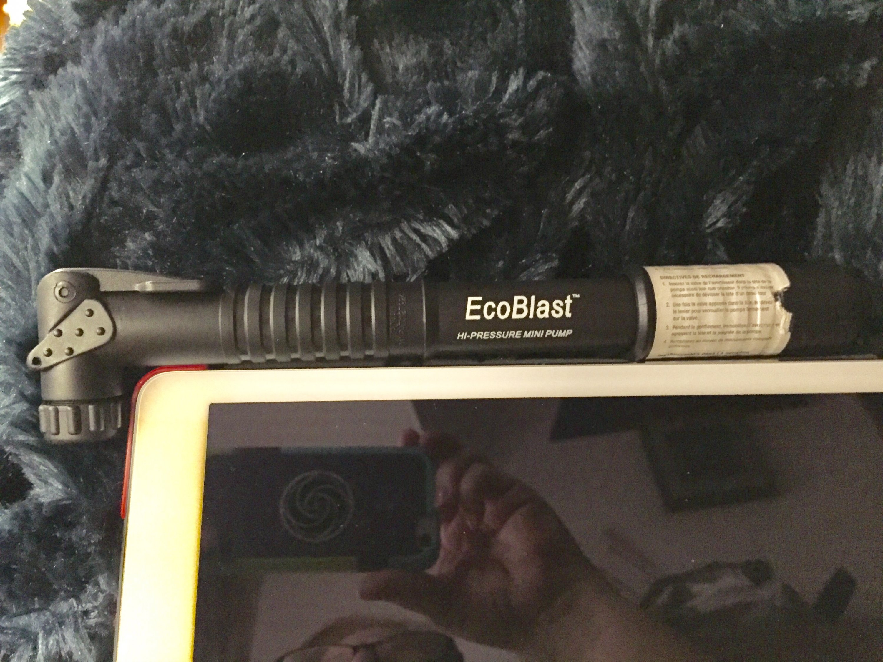

The results - we shocked the tanks, followed all instructions, no more snot. Interesting part is that I had noticed my blue 3M scrubber sponges used for dishwashing never used to stink but had started stinking during the snot phase within a couple days of putting a new one out. After destroying the snot the sponges never have an odor. They get tossed out because they fall apart first. The accumulator tank seems to fill with water when we run a water tank low to the point of sucking air. We have learned the the little air pump that came with our refillable air horn works great to repressurize it.

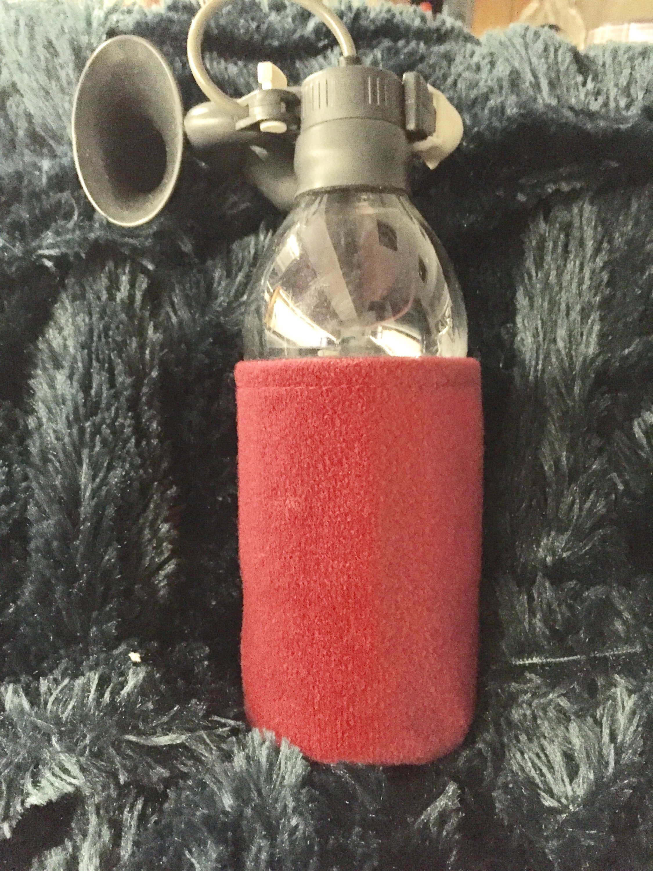

You have a refillable air horn? Tell me more, please!
Sep 11, 2015
52
Beneteau 43 Sense San Francisco Bay
West Marine has one for $36. Ours was a gift, they look identical. Lots of nasty reviews. We have had it for 5 years but don't use it much. I suspect people are over filling.
Ours says Air Zound, pump says Echo Blast.
