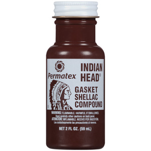

I still use the old Permatex® Indian Head® Gasket Shellac Compound that I've always used, for both gas and diesel. I really don't think there's anything better, it's cheap and it has never once failed, yet it comes apart easily. A 2oz bottle lasts forever! Thread tape is not recommended for fuel lines, mainly because bits can get into the fuel system and......
For really difficult seals, Permatex Form-A-Gasket No. 2 Sealant (3 oz.) always does the job for non-food grade connections.
Good enough for me! One click at Amazon, $3.22, it will be here in 48 hours. Thanks! :beer:
