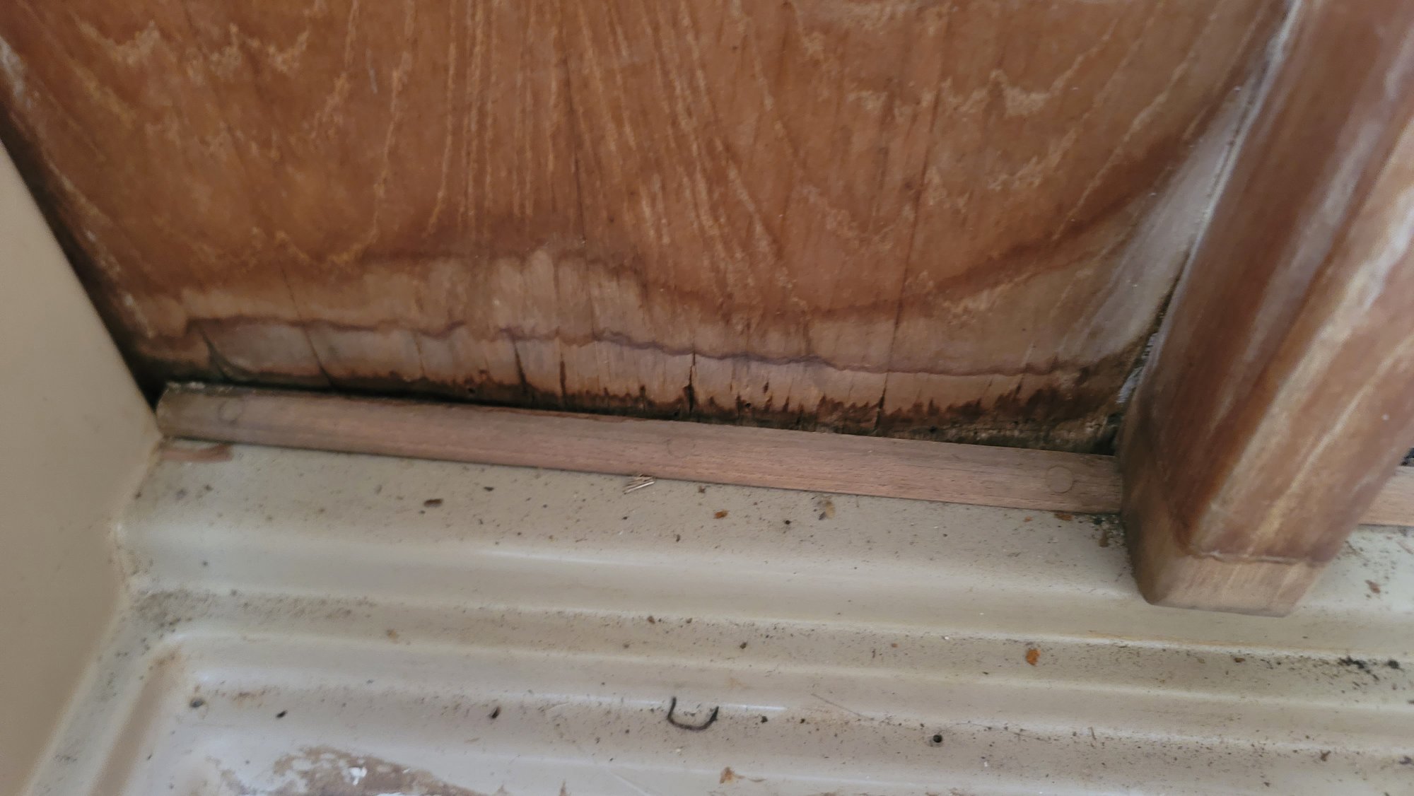

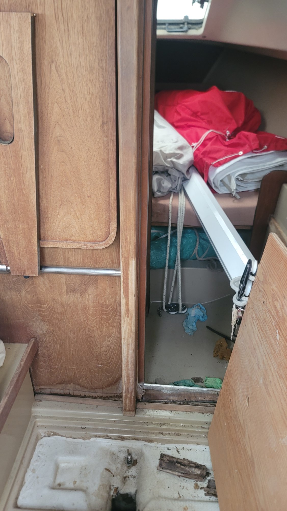

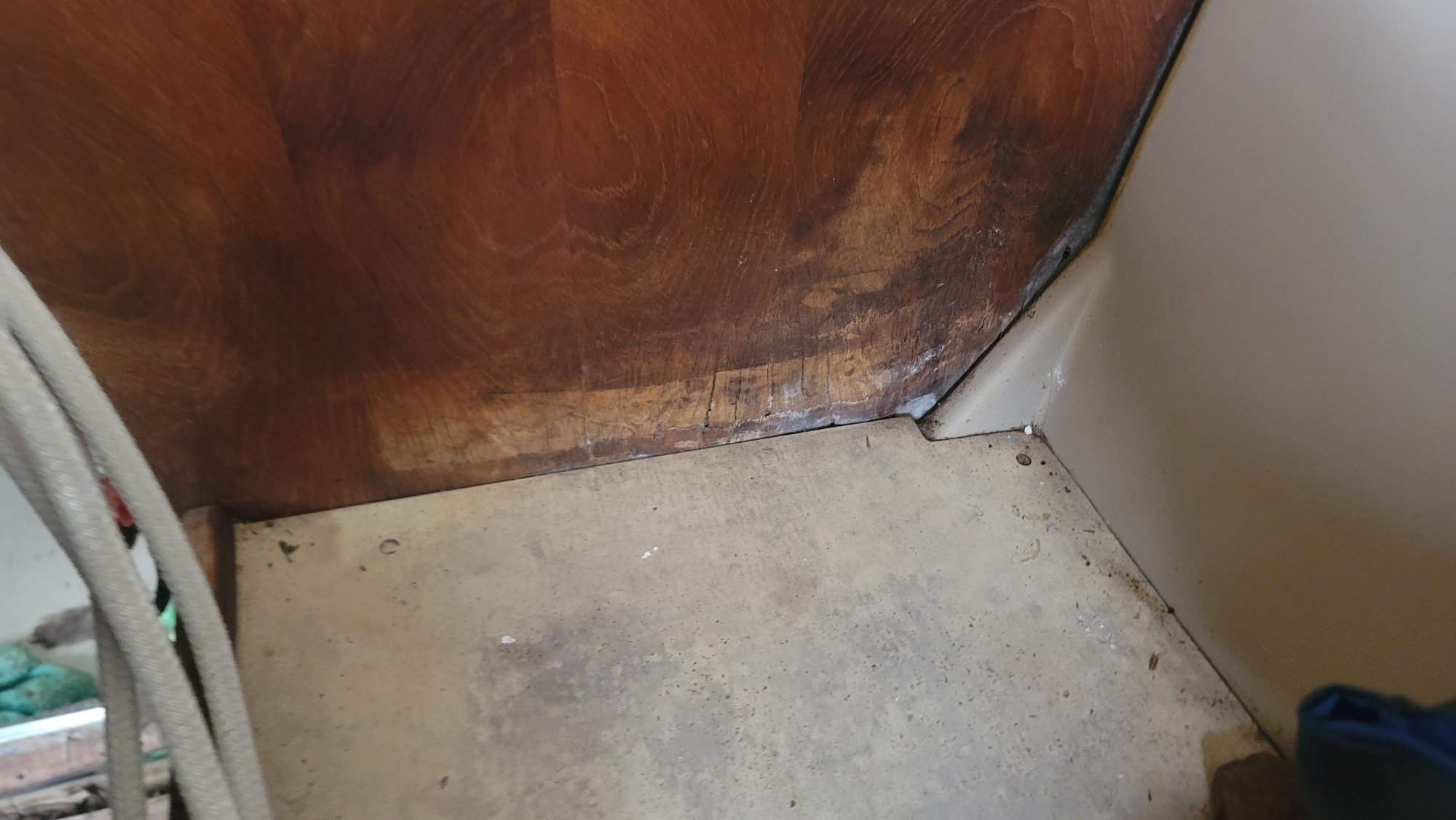

So I've examined the boat and the bulkhead is rotted all the way around. Looks like it came in from the anchors for the rigging. The very center where the openings are to go from the main cabin to the Bow cabin are fine, but the entire Edge where it meets the fiberglass hull can be poked easily with a screwdriver. It's basically crumbling around the edge. Thoughts on how hard of a repair that is?
If the forward bulkhead is rotted out, I'd suspect other places are rotted as well. Also if the bulkhead is rotted because the chainplates leak, the deck may be rotting too.

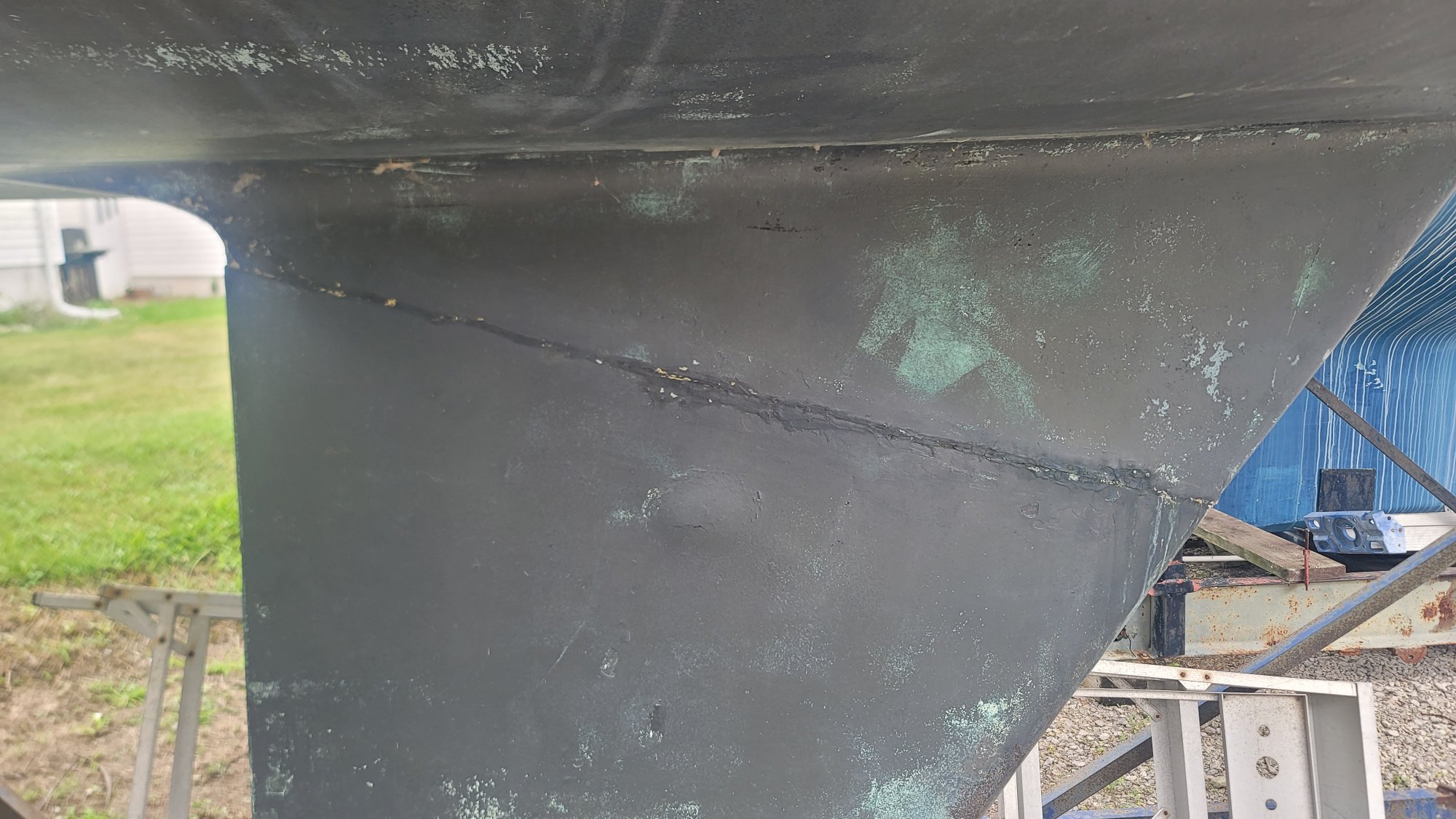

That's what I was worried about too. I did find some soft spots on the deck, especially around the lifeline posts, but it was hard to view it since it was under a accessible wrap. It accessibility was maybe a foot and a half to 2 ft tall. On top of that, the keel has a split going down the middle of it at an angle. I can't call it the C&C smile because it's a little too low on the keel so I suspect it's had a few impacts as well.

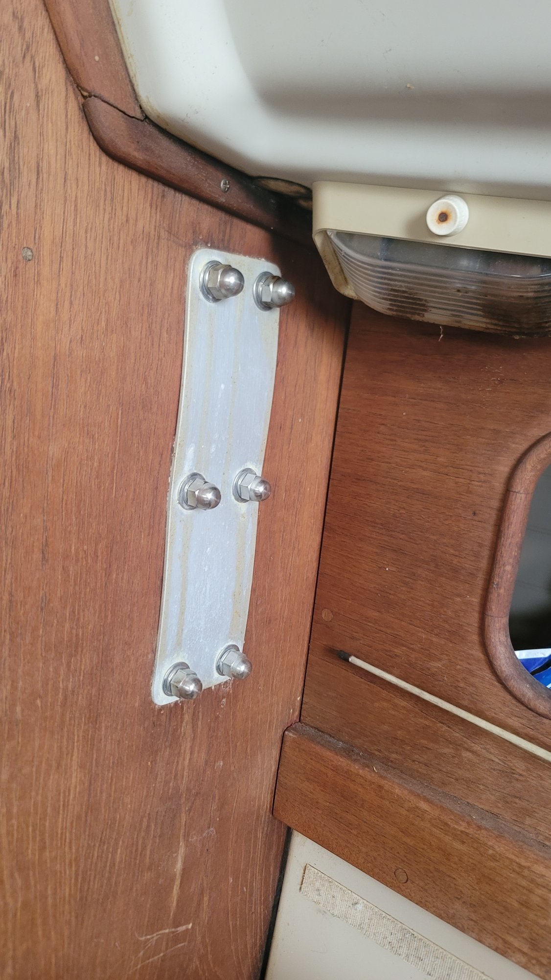

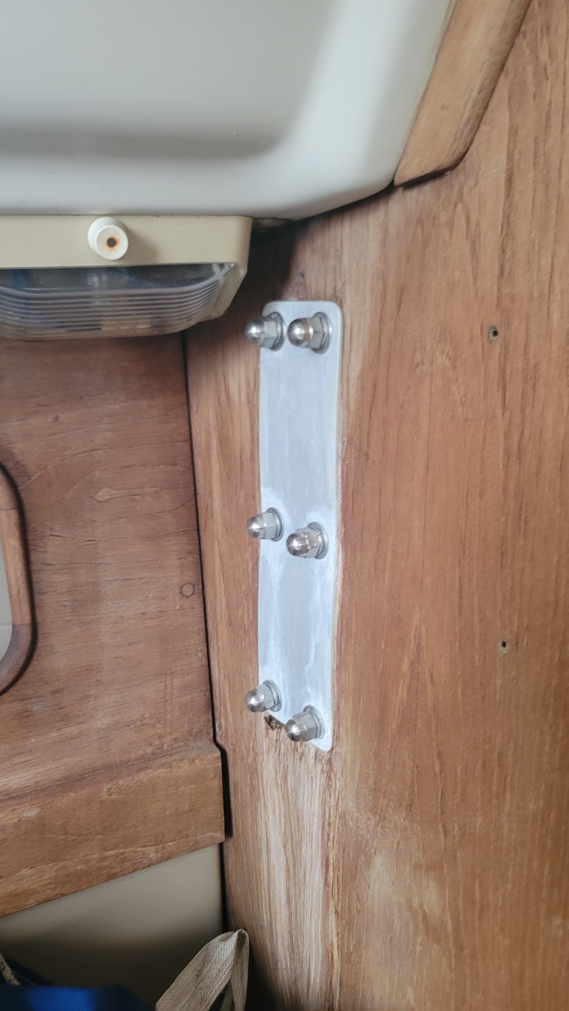

Okay. Some of the wood is rotted, and some looks water-stained and may not be rotted. The image of the chainplate looks like there has been a deck leak, and the wood is swollen (wavy) but compressed by the bolts.
The keel looks to be showing you the line between the stub and the bottom half of the keel. Inspect it and confirm that the keel is firmly on the boat. There may be bolts and nuts viewable from inside the bilge.
If solid, then you are talking preventive surfacing. You can grind out the filler, refill the gap, and then barrier coat your filler and repaint with bottom paint.
The wood above and below the chain plates is completely rotted. I brought a screwdriver with me just to see if it would pass a poke test and it was so soft that if I had pushed any harder my screwdriver would have gone through it.

The keel crack looks like a normal junction between the stub and the ballast. Why C&C designed it on an angle is a mystery to me. But that wouldn't kill the deal for me.
