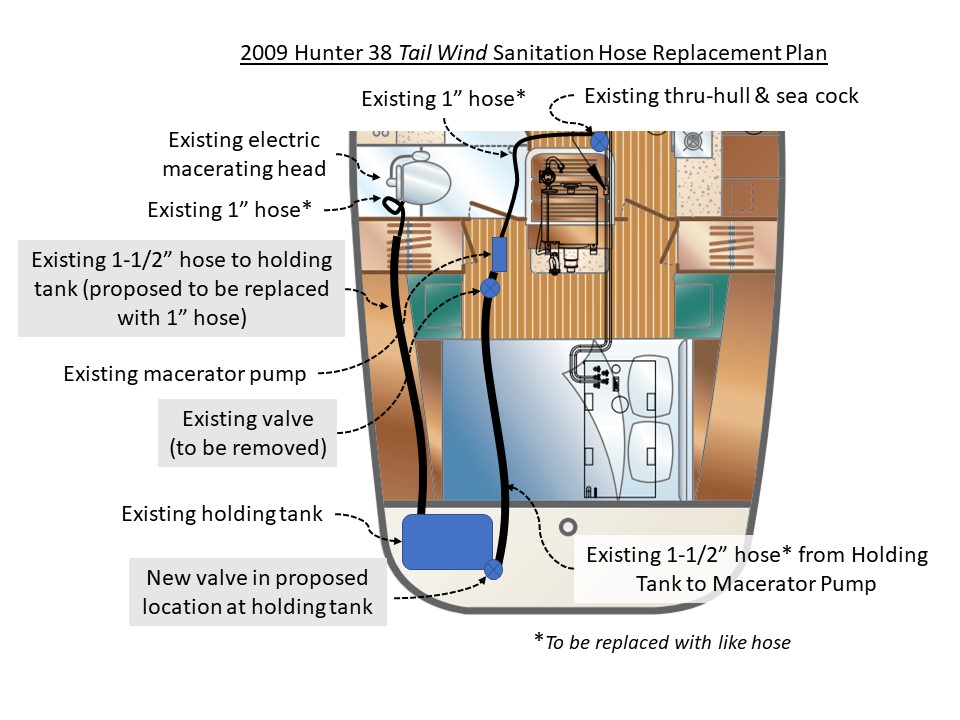

2009 Hunter 38, original configuration: The hose coming out of the head (toilet) is 1", makes an odor-trapping loop and runs through a bulkhead where it is coupled to a 1-1/2" hose that runs maybe 9 or 10 feet to the holding tank. The head has an electric macerator the grinds everything (noisily) into mush. Why bother with the 1-1/2" hose? Why not run 1" hose the entire length to the holding tank? I am not trying to be cheap where it counts, but aside from the extra $100 to run the 1-1/2" hose, that hose is going to be holding more of what I do not want stinking up the aft berth. Granted, the new hose will not be permeated for years to come, but still, is there a reason to go from 1" to 1-1/2"? For a more complete scenario (see graphic): The hose running from the tank to the thru-hull (for dumping at sea where allowed) is 1-1/2" for ~10 feet to a second macerator pump, the output of which is a 1" hose. I could see the sludge coagulating at the bottom of the holding tank so can understand the 1-1/2" between there and the 2nd macerator pump. I will note that I plan to make a significant change from the original configuration: the shut-off valve that rarely (if ever) that is to be opened for external dumping will be relocated to the output of the tank at the tank instead of 8-10 feet away at the (2nd) macerator pump--full of sludge. (What kind of logic was that?)

The exception, based on the original configuration with the plumbing, had the valve for the overboard discharge at the macerator pump (~9’ of 1-1/2” hose). The first tank full of waste (perhaps in 2010), had the solids settle in that 1-1/2” overboard waste hose, which had never gone overboard due to the regulations on dumping. That waste broke down over time but sat there for perhaps 9 or 10 years. That was beyond the permeation limit of the original hose – and was just the job you might imagine when I removed that hose last fall and closed off the holding tank where I am showing the new valve location in my updated diagram. I will be putting in that valve, 1-1/2” hose, and macerator as the boat, though based where no dumping is allowed, will find its way to the Atlantic Ocean and may need overboard dumping (where allowed).
