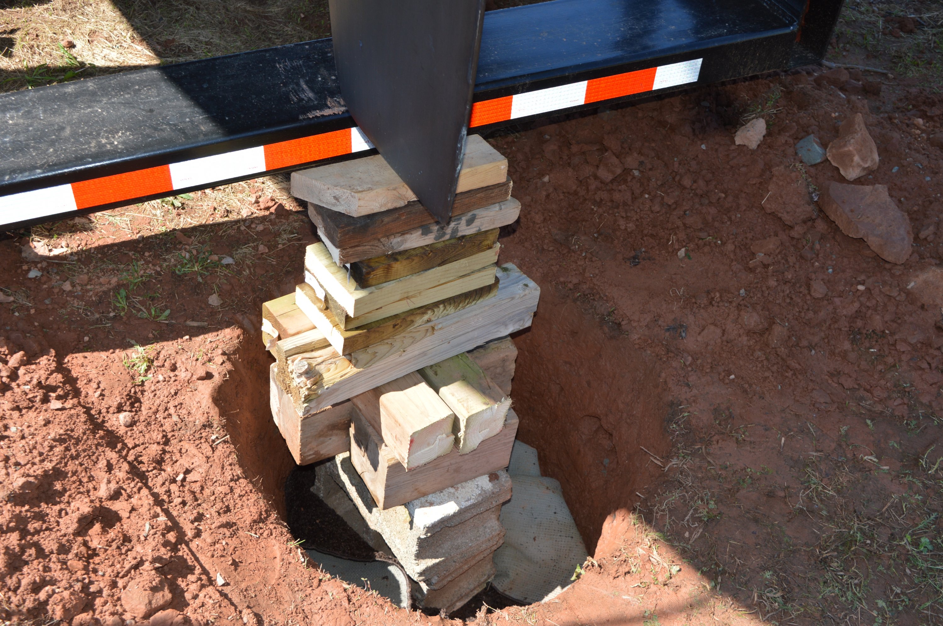

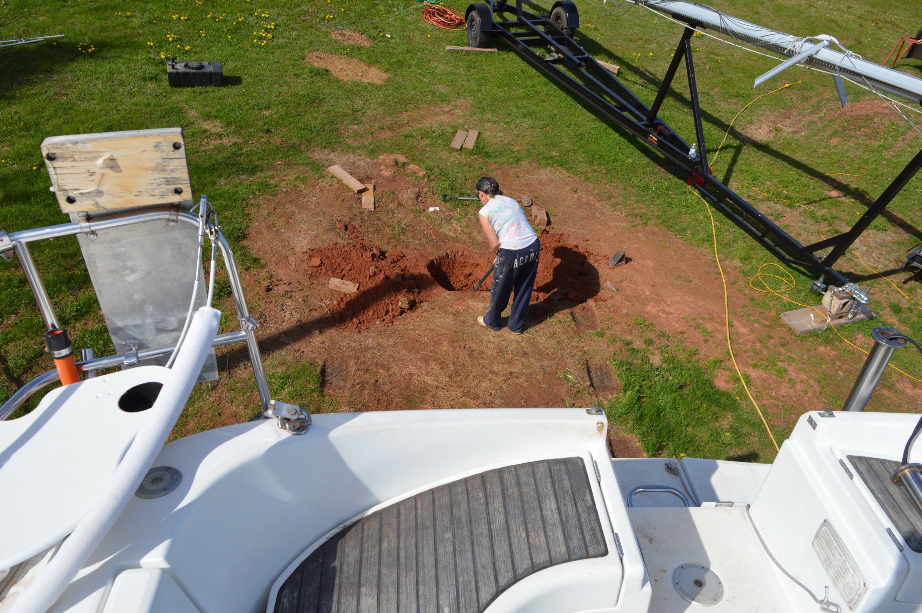

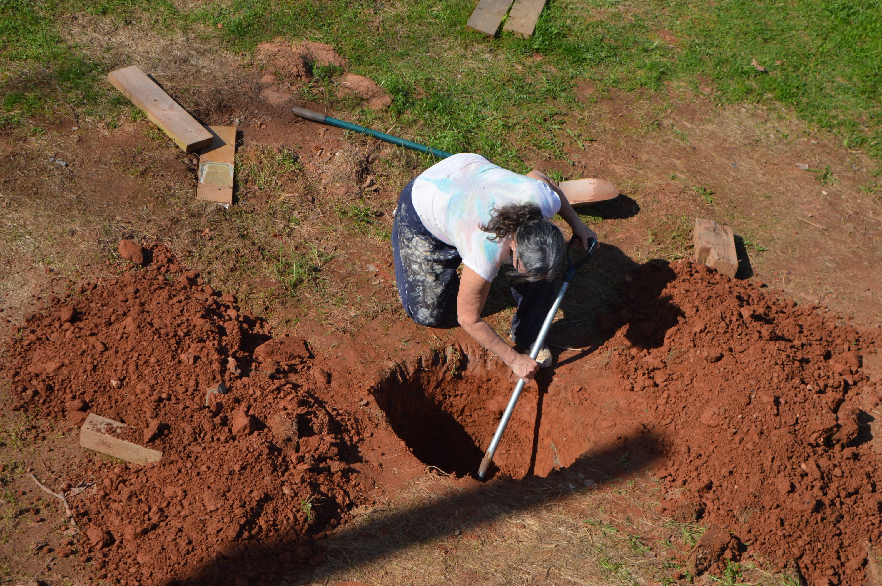

Fact: There are few, if any 5 minute jobs/repairs on a boat! Doing a cutless bearing, shaft seal ,getting ready to drop the rudder, (My wife is so great, that's her digging the hole, 58yrs old and still got it!) Going to change the Volvo seal to a PSS, stern tube is reduced in size at the end and too short to accept the new seal, so planning on adding an inch or so.

It actually took a lot more then 5 minutes to dig the hole.
The boat is on the trailer, I moved it forward so she could dig, then I'll just back over it (yes, she really wants to get back in the water soon!) Hmm, my life insurance is paid up, the hole is about 3' deep, and as short as I am, I still won't fit,haha

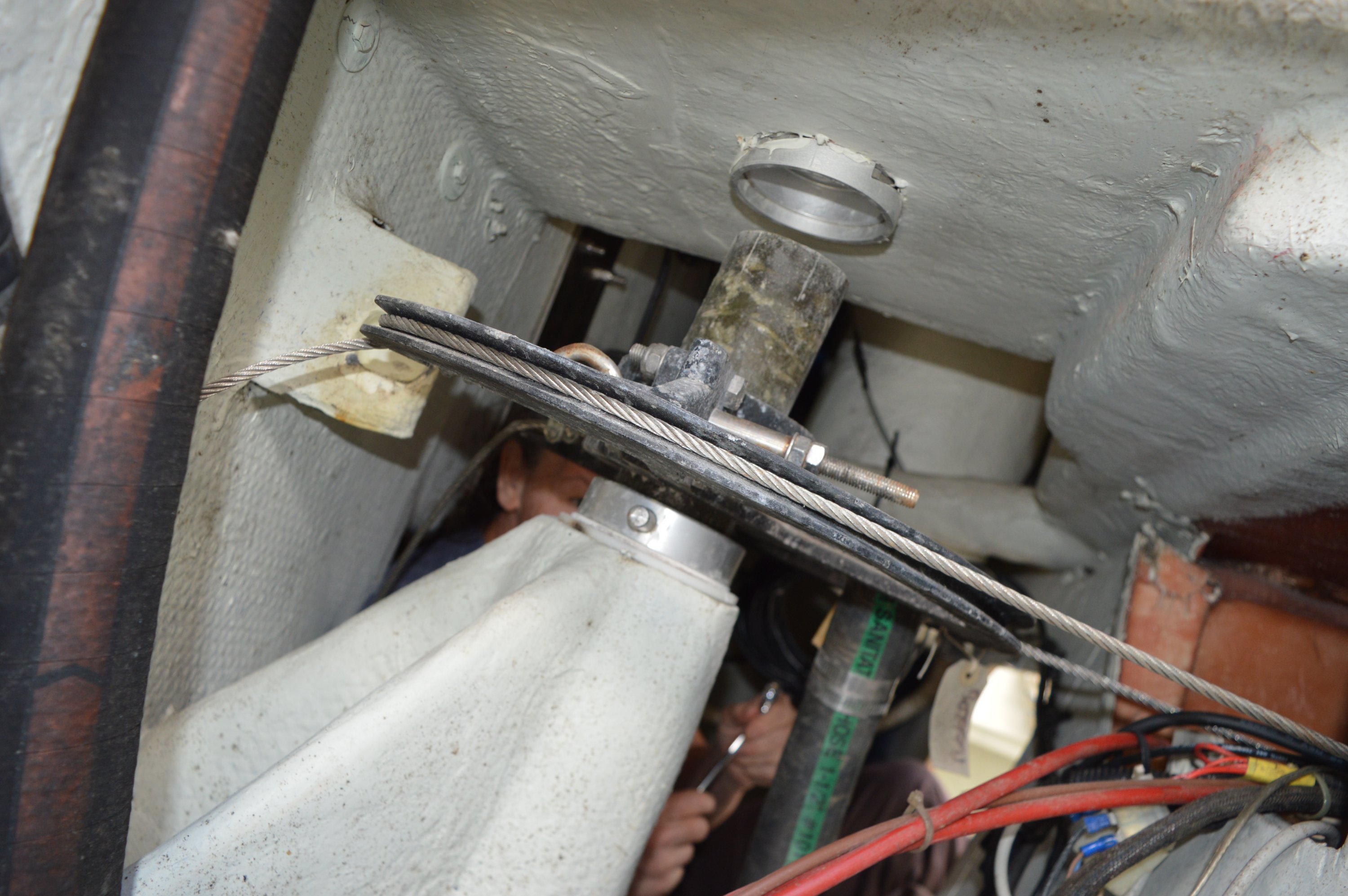

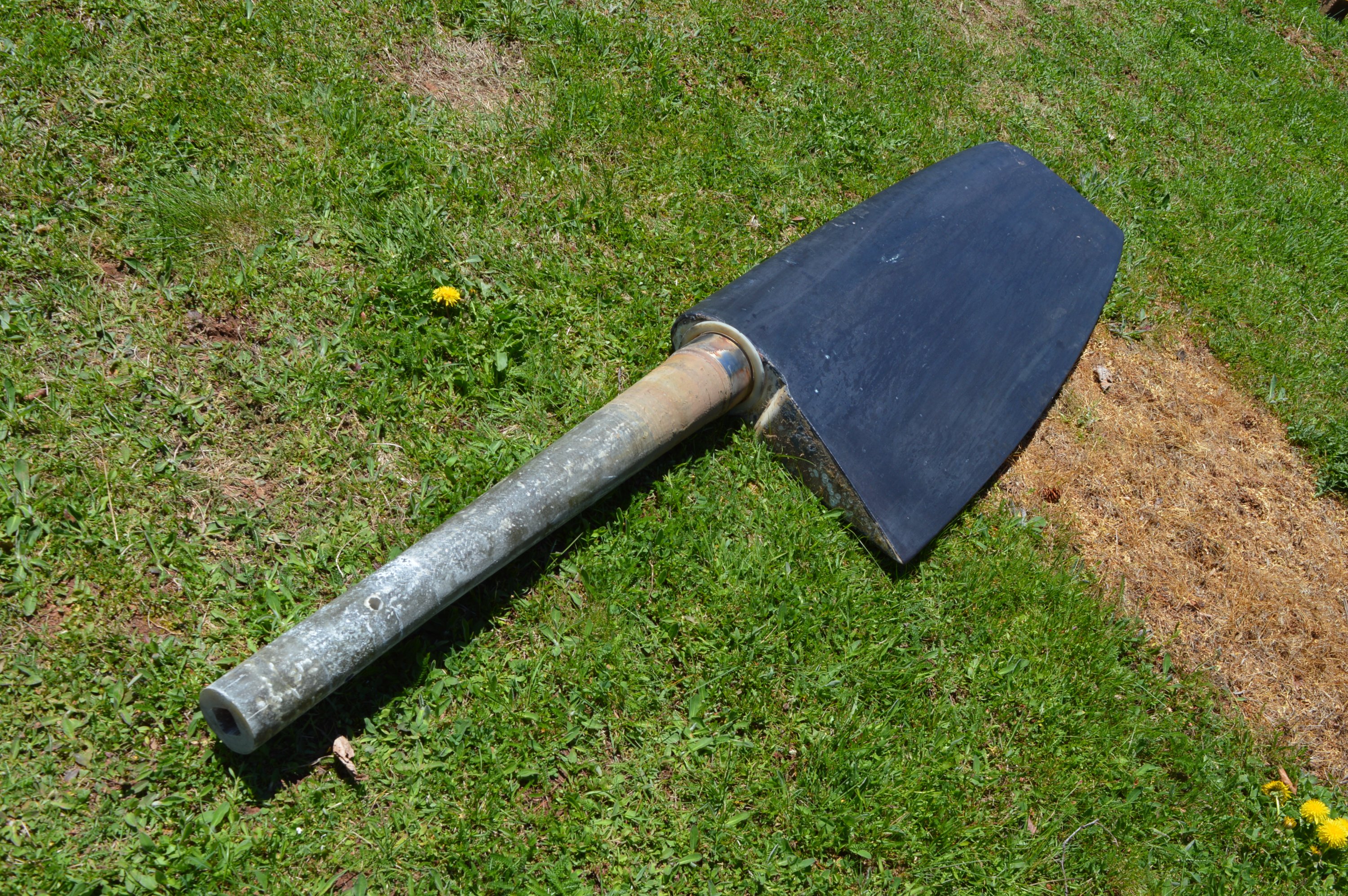

Well, rudder's off, shaft is out, all is good so far! Wife jumped in and loosened the bolts on the quadrant (someone had that info posted on here somewhere, thanks for that!)
Jul 7, 2004
8,496
Hunter 30T Cheney, KS
These all look like familiar scenes from my same project, except the admiral is nowhere to be seen! In all fairness, I'd rather spare her back.
I went with a Lasdrop Gen II seal. The shaft had to be straightened slightly before the fit and facing was done. So far so good. Good luck on your project Brian. Kudos to the wife!
