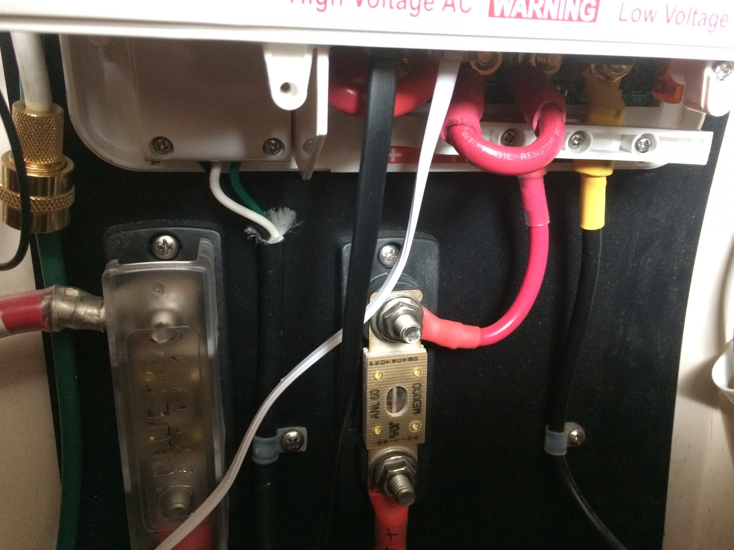

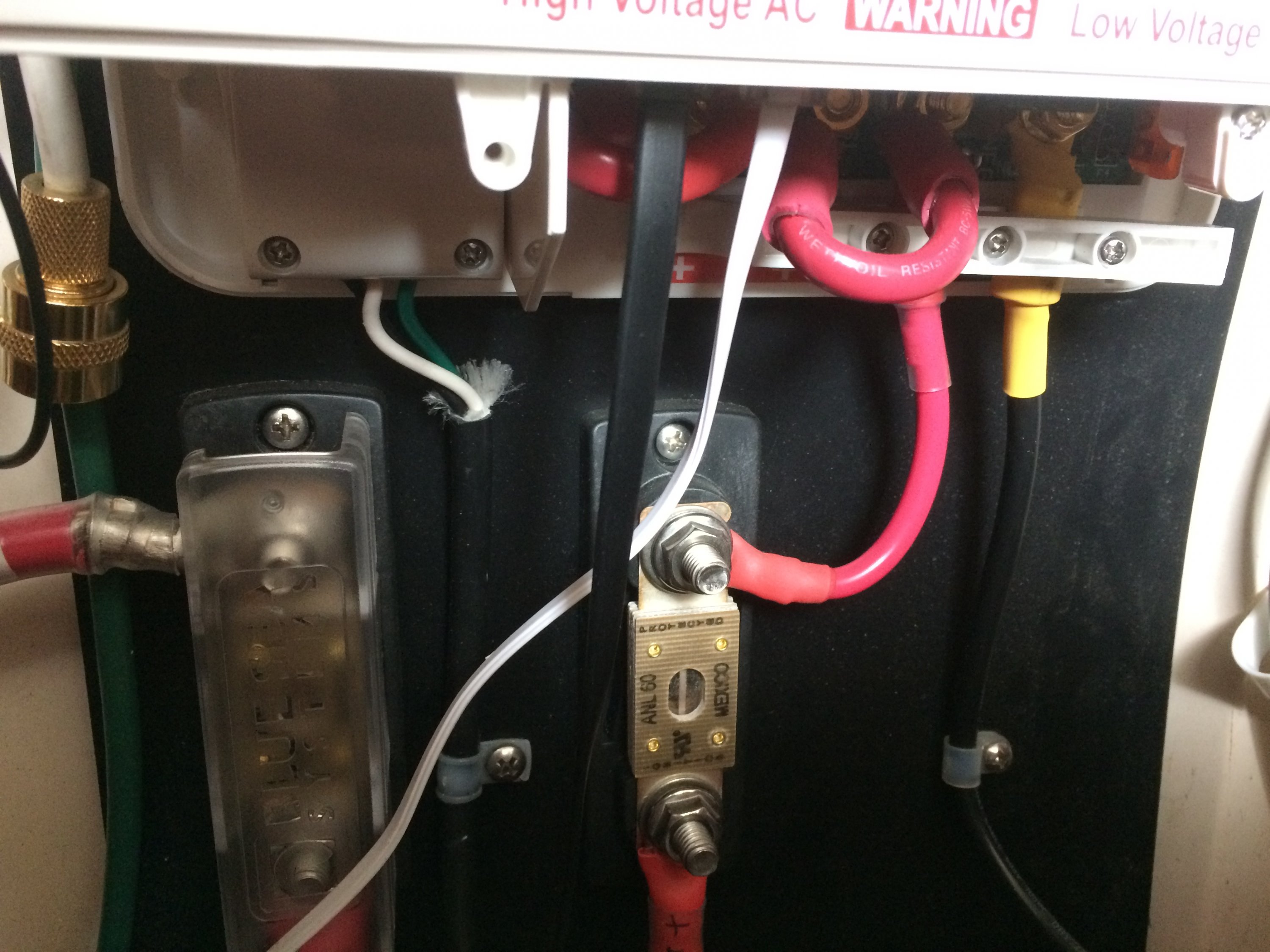

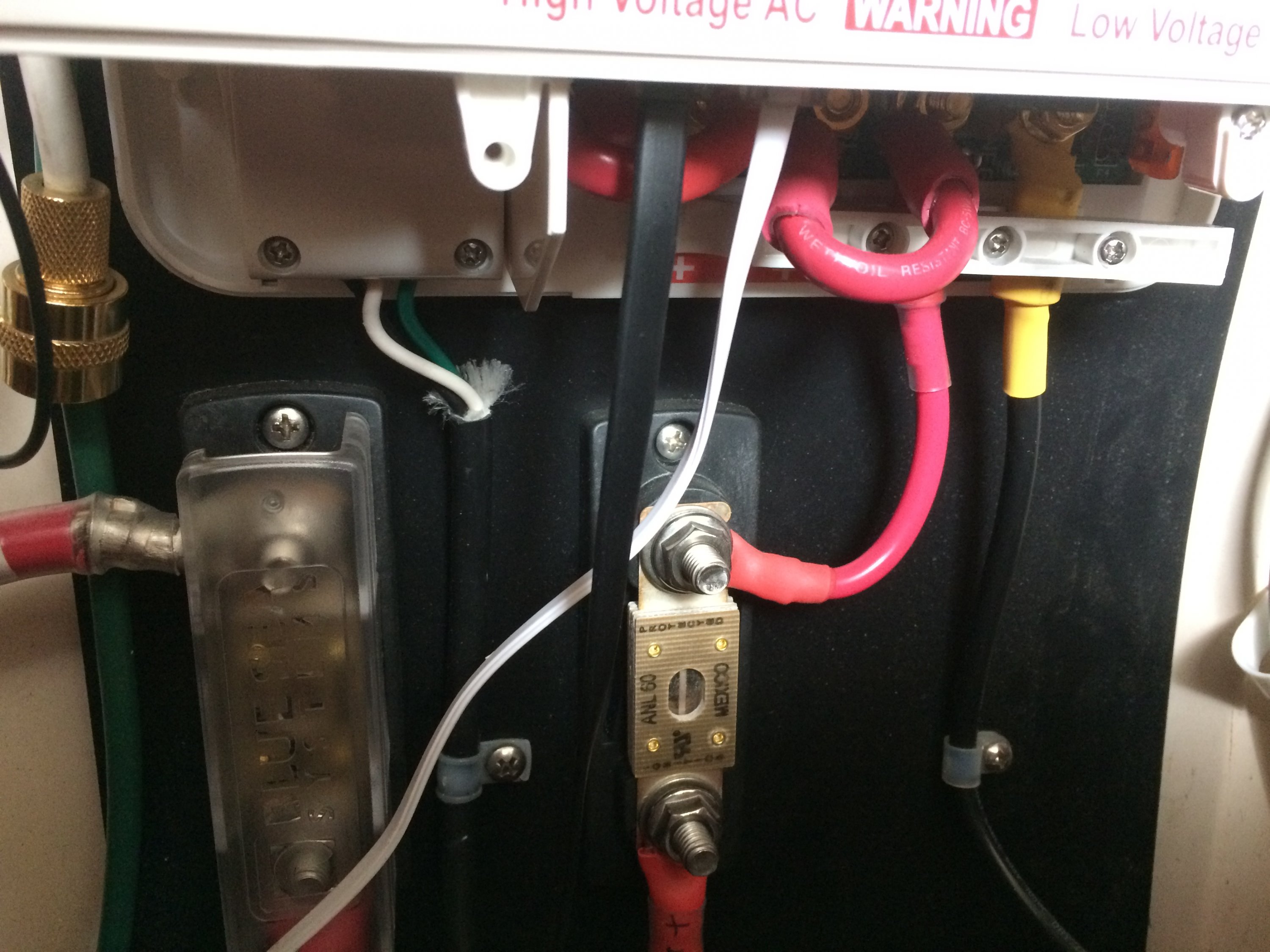

So then, can I connect the dc + output here at the fuse?
#1 Fuse goes at battery end of positive wire not at the charger end. The fuse is to protect the WIRE not the charger... It is protecting the wire from the battery bank not from the charger.
#2
A 60A fuse is way too small for a 60A charger and far too small for 120A of parallel chargers. A 60A charger needs a bare minimum of a 75A fuse and two 60A chargers would need a 150A fuse. Again this goes at the battery end of the circuit within 7" of the + post or distribution bus.
#3
If you bus the two chargers together at the charger end, which is the least expensive and least invasive option, you will need larger wire run over to the bank, from the bus point, because now you have a 120A charger.
#4 The volt drop calcs for a 60A charger will not be sufficient for a 120A charge circuit so the existing cable between battery and charger will be too small.. The wire for the circuit length (pos & neg lengths added together for total circuit length) should be sized for no more than a 3% voltage drop at 120A. 2% is even better.
#5 Get some heat shrink on that lug because if that PL-259 / VHF terminal touches it, it won't be pretty........
Sep 2, 2011
1,041
Hunter 27 Cherubini Alum Creek State Park
Thank you RC.
#1. Myself, and I bet a lot of other people, tend to think of electrons as flowing in one direction, away from an output via the pos cable and returning via the neg. with that picture in mind it made sense to protect the wire downstream of the output lug. I'll move it into the battery compartment and replace it with a buss bar. And #2, I'll install a 200 amp fuse.
#3&4. Guess I'll be ordering some more wire and lugs as well. Do you think 1awg would be sufficient?
#5. Look closer, old man, that's clear heatshrink on that lug. (Yeah, I have to take my glasses off and plant my nose on the screen to see it in that pic).
