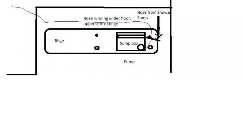

The set up is very simple. My sump box pumped from the side of the box where the drain went into. This means the hoses faced towards the head. I simply ran the drain hose from the shower to the box (it does have a hair trap) and then I ran the hose from the sump box through the side of the bilge to the area under the galley. I went up into the galley sink cabinet to put the vented loop (there is probably another vented loop in that location already) and then ran back down to the sink drain. I will see if I can draw out a really rough drawing to help you.
May 23, 2004
3,319
Very Rough Diagram......See if you can understand it. The wires for the switch from the pump that runs into the head have to run back the same direction as the drain hose, then go into the area where the holding tank is, up through the area following the holding tank vent hose, into the compartment, down that side, and I have the switch mounted on the teak strip above the sink, under the window, above the medicine cabinet.
